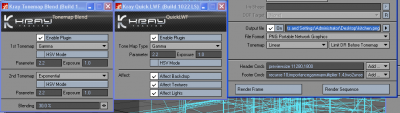

When using Kray Tonemap Blending, do I need KrayQuickLWF or do I have to turn it off or does Kray use them both side by side. If it uses both what are the preferred settings for KrayQuickLWF? Linear? Thanks.
Re: Kray Tonemap Blending

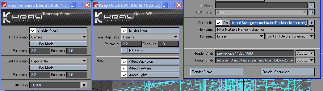

This is correct setup (and the best)
30% means: 70% exponential and 30% gamma.
Important! Tonemap in Kray MUST BE OFF : Linear

Many thanks Johny_quick.
