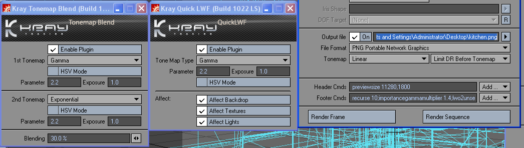

When using Kray Tonemap Blending, do I need KrayQuickLWF or do I have to turn it off or does Kray use them both side by side. If it uses both what are the preferred settings for KrayQuickLWF? Linear? Thanks.
Re: Kray Tonemap Blending
This is correct setup (and the best)
30% means: 70% exponential and 30% gamma.
Important! Tonemap in Kray MUST BE OFF : Linear

LWF keep real colours so we don`t need it. But You can testbrownie wrote:so, no HSV mode?
HSV is old trick for Exponential , becouse exponential too much kill colours and too much chenge it.
IF You have 30% gamma with LWF this is enough...more gamma = more colours and more overbright areas.

Basic is: LINEAR in Kray (so is OFF this is important) + LWF gamma 1.4-2.2 + Reinhard gamma SAME as in LWF, exponential 2.2, blending 30-50%. But of coarse feel free! all setup are good when You have good result. LWF and First tonemaping in Reinhard must be same. When gamma is 1.2 in reinhard must be 1.2, when You use LWF LINEAR in Reinhard You must use LINEAR as first tonemp, second tonemap : feel free
