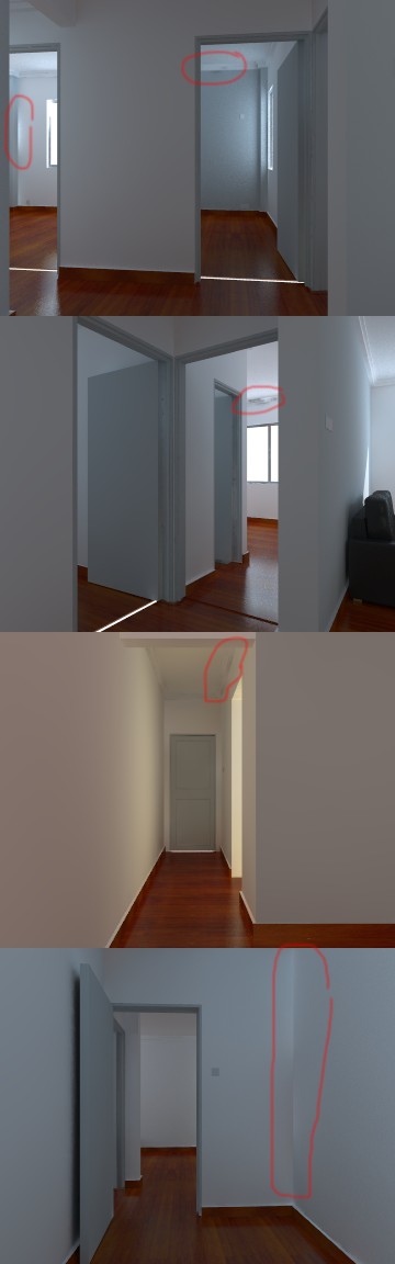

anyone know how to fix this???

hmm looks like a light leak. Check your geometry.

Could You show Hires render??

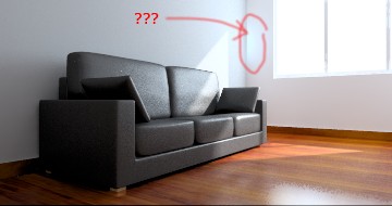

this is another View.....

You have poor irradiance settings i think..
What are your settings on Photons tab?

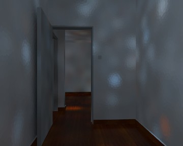

Can you post photon estimate>precomputed render please?

this is precomputed render

Ok as you see those bright spots in this render are not going to do any good. Your precompute render should be as smooth as possible.
Increase N to 1000 and Precache blur to 300%. If it doesn't smooth it out then increase it even more.
