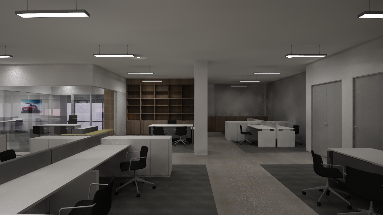

hi guys,
i am working on the animation of office interior. I did some test render and found the splotch at wall, ceiling and cabinet. How can I solve this problem. :wink:
Thank you..
Re: problem with splotch
Skyportals :wink:
Please upload scene (no furniture, only walls) if You can.
If not then increase N parameter up to 3000.
Also check GI resolution: ~ 300 mm
Put bigger min/max rays for FG: 400/2000
Put 2 passes.
If You have still problems then put shader Limit DR for ceiling lamps.
This is "deep corner" so photons has always problem to by attach correctly on the surfaces. This is normal and only Skyportals can help (but not now - is too difficult)
Those splotches appear, because balance between photons from lamps and photons from another sources of light are not correct. Also this is normal. You can use correction tool: Luminosity Number Multiplier (try ~5000).
