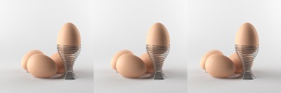

Here's a simple example of autostereogram.
