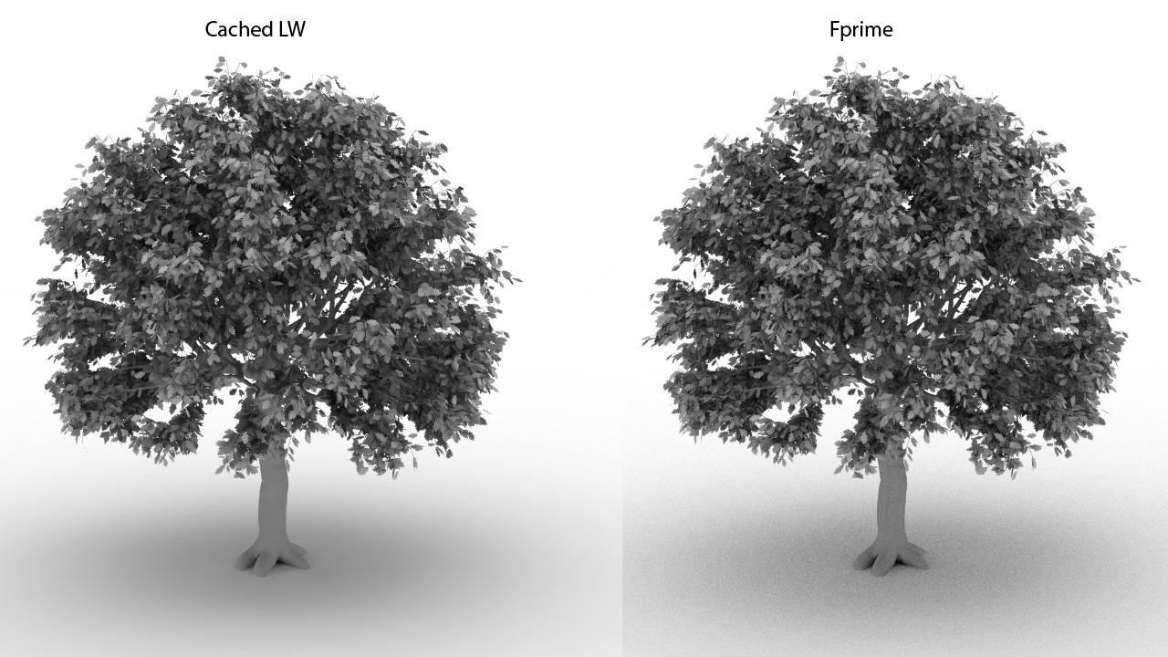

Incited by some thread on the NT forums, I tried again to render foliage in Kray. I do like the prospect of using its nicer translucency and hailed superspeed. I always need animation, camera animation that is, so not too much jitter between frames would be nice and some caching to reduce rendertimes.
To compare a bit, I set up a test scene. Really simple scene, no instances (yet) and all textures stripped out.
LW native first:
Baking GI took about 25 seconds. Then rendered it which took 5.6 to 10 seconds per frame (4 AA). Result attached. This is what I would normally use, if not using a tree with GI baked into verts or UV map. It does require a bit of odd "trick" on the global GI settings but ok. Stable, contact shadows and cached (15 MB here). Added a comparison to Fprime which it matches quite well. (sort of consider Fprime "perfect", no transl ofc)

Cached LW matches Fp
