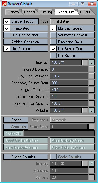

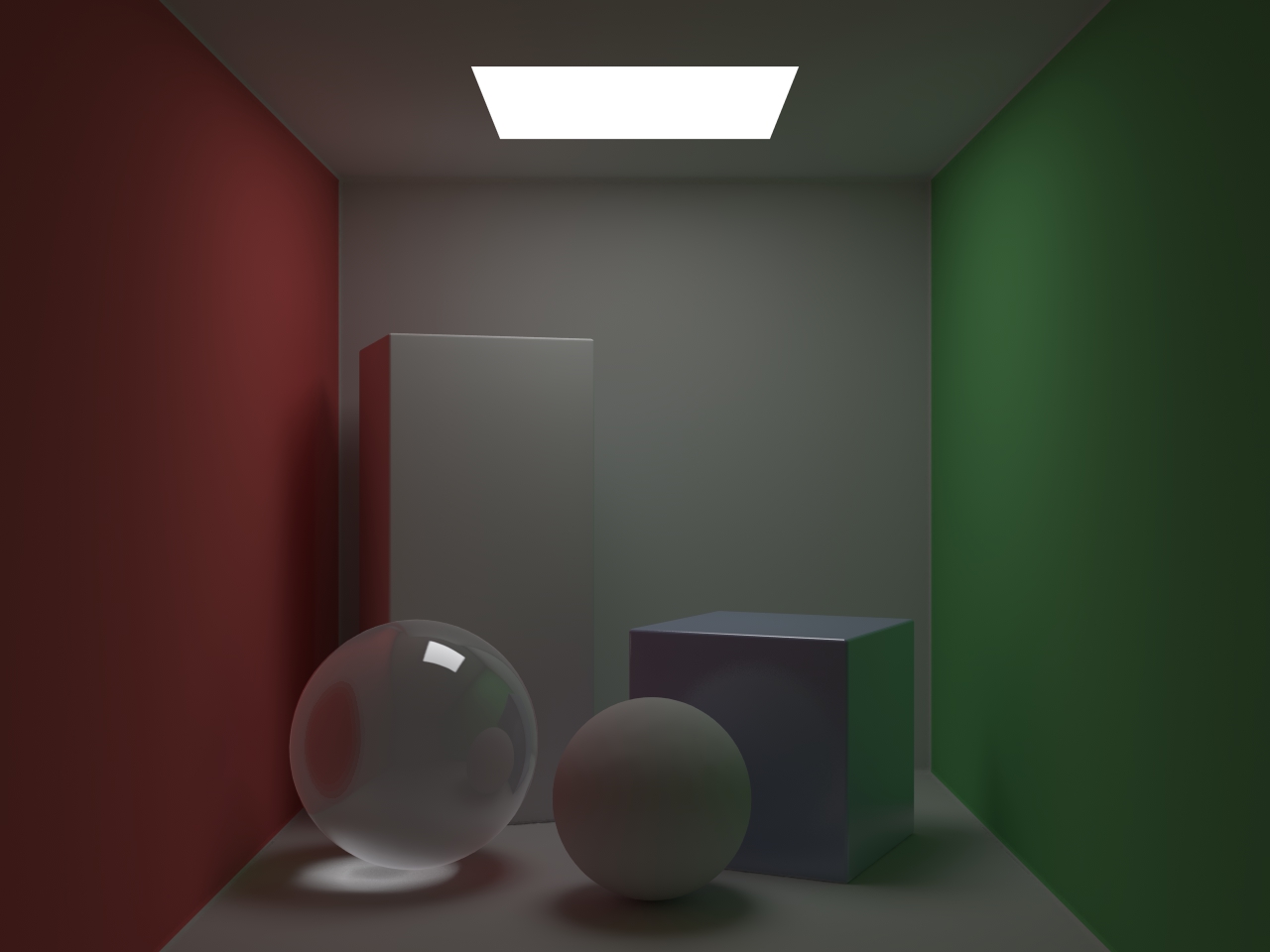

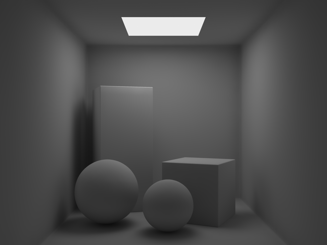

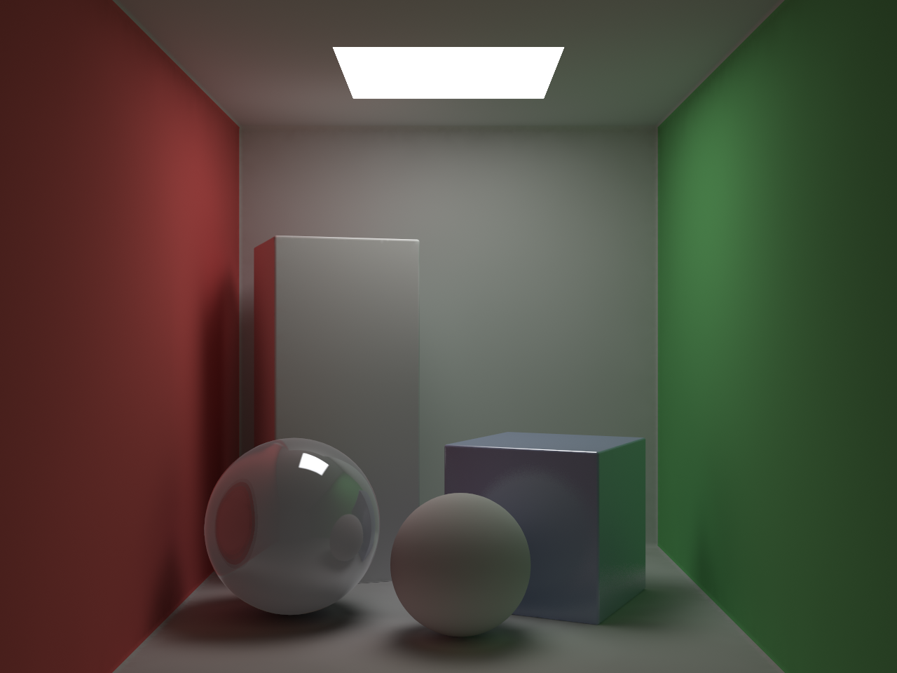

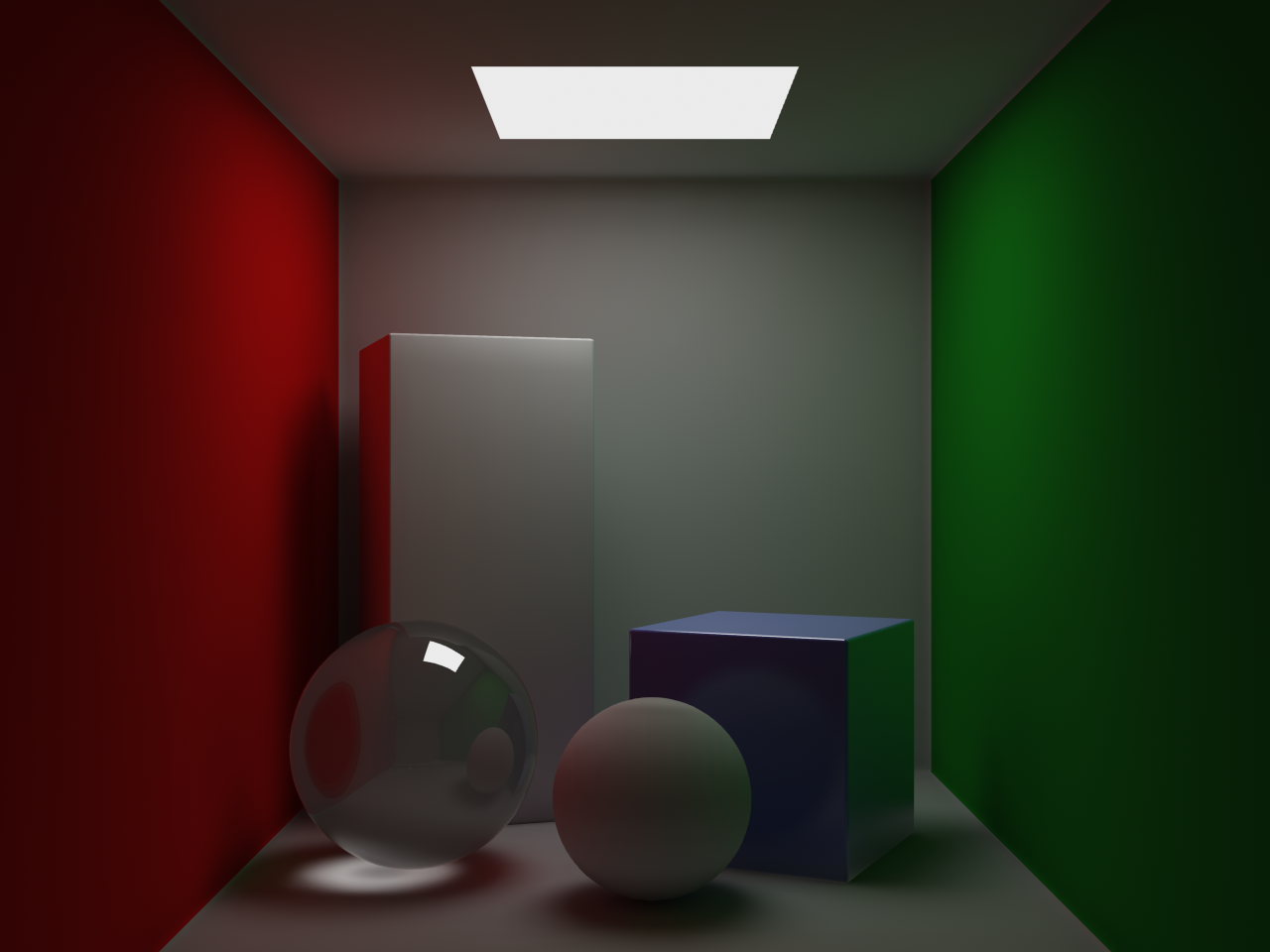

So, for starters the render straight from LW native, in 2min 50 sec (i7 @ 3.5 ghz):
LW native render
LW native render
with settings:
LW native settings
LW native settings

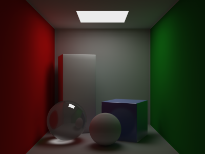

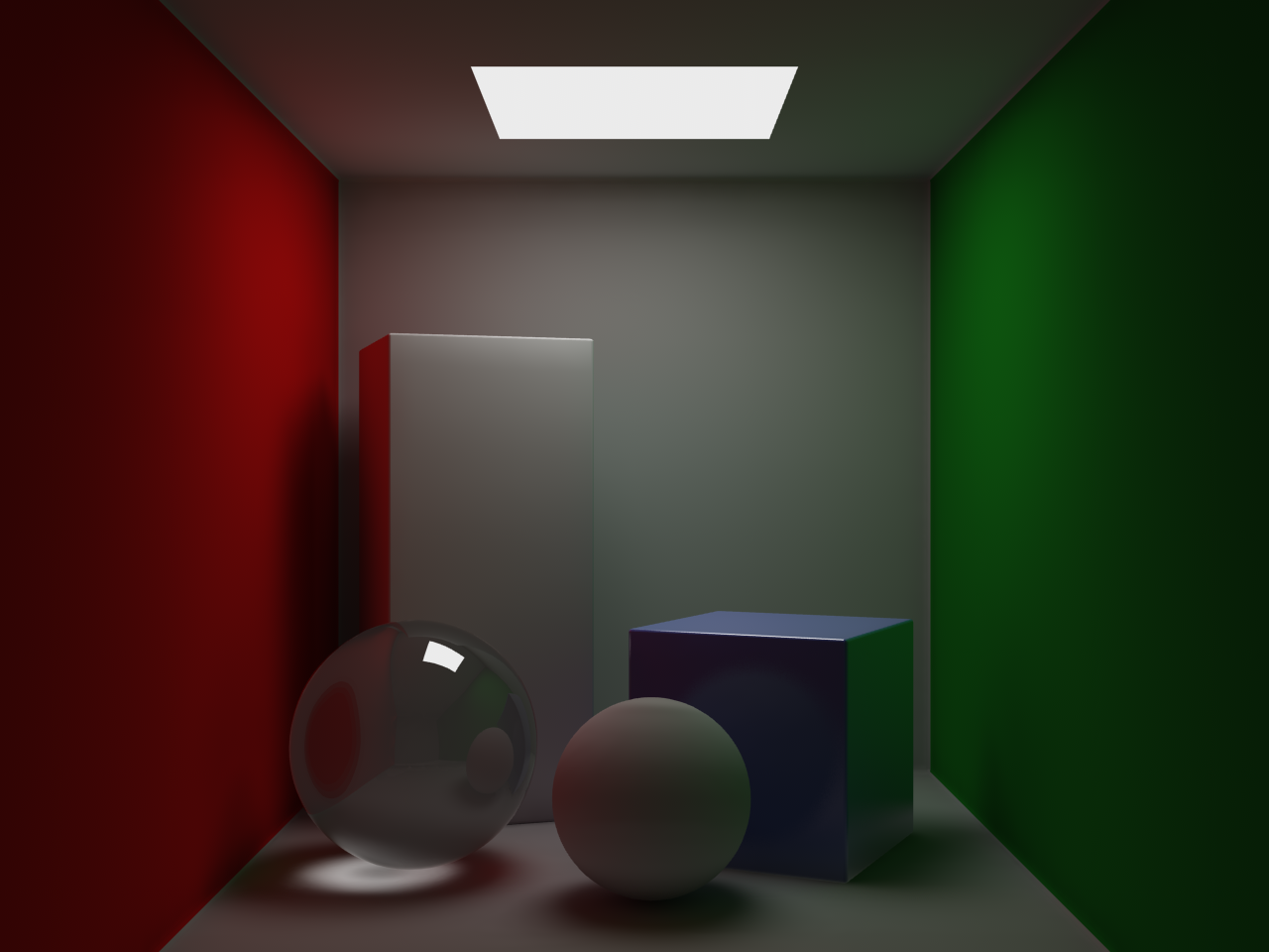

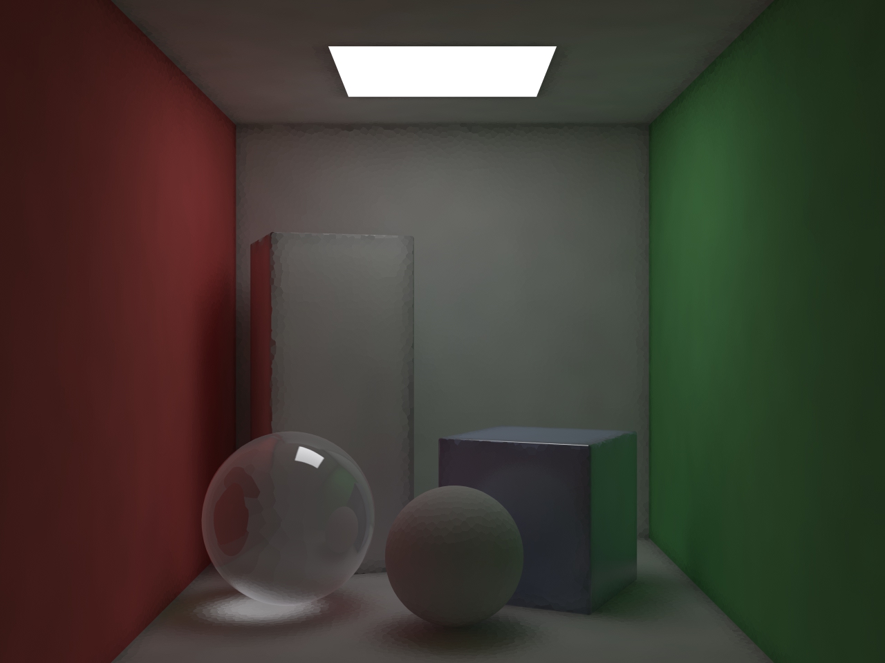

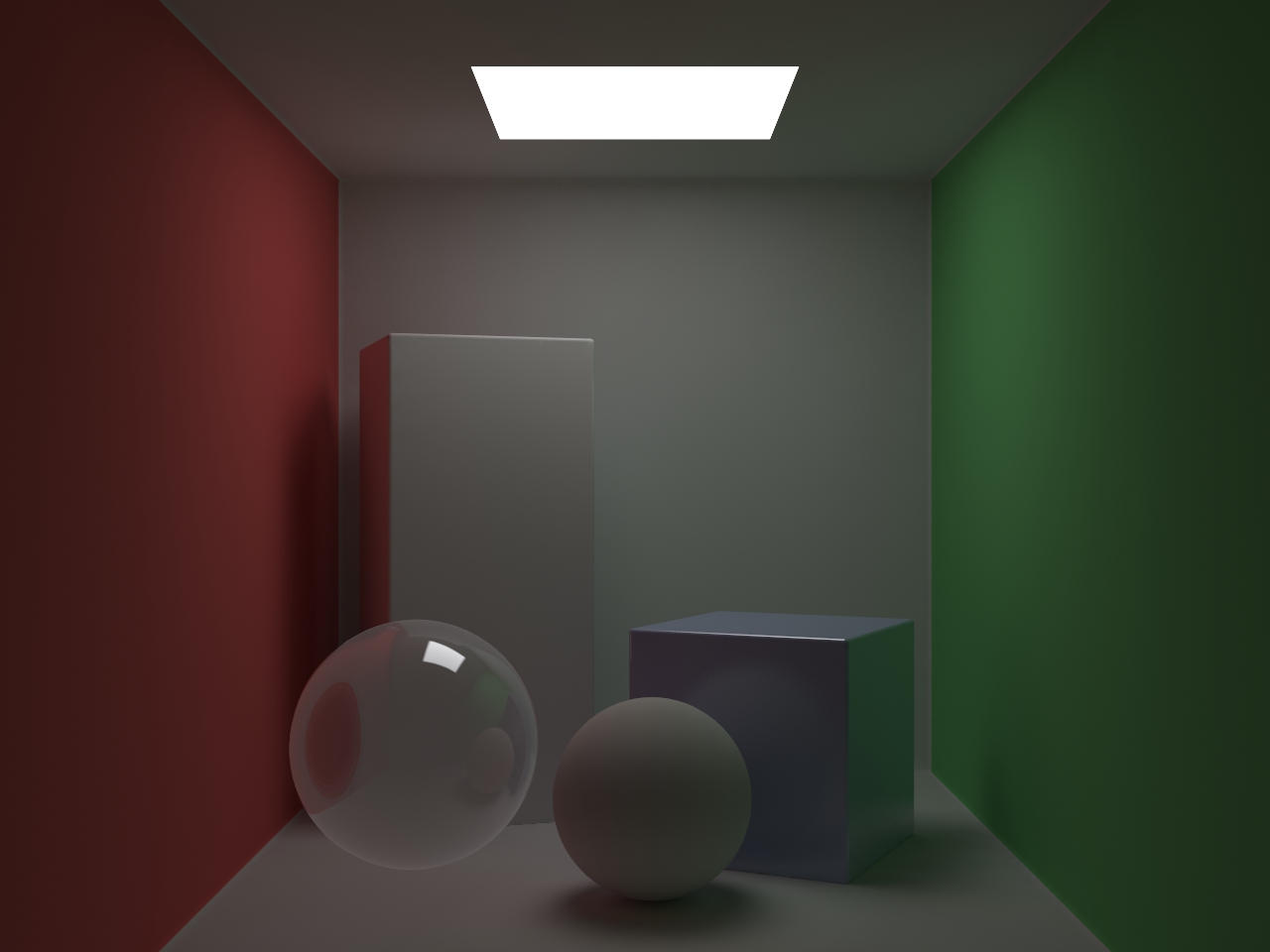

Followed by my current Kray render in 4 min 58s:
Kray render
Kray render

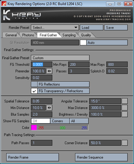

with settings:
Kray FG settings
Kray FG settings

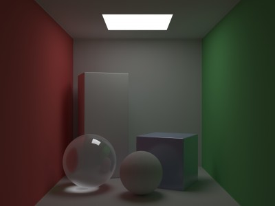

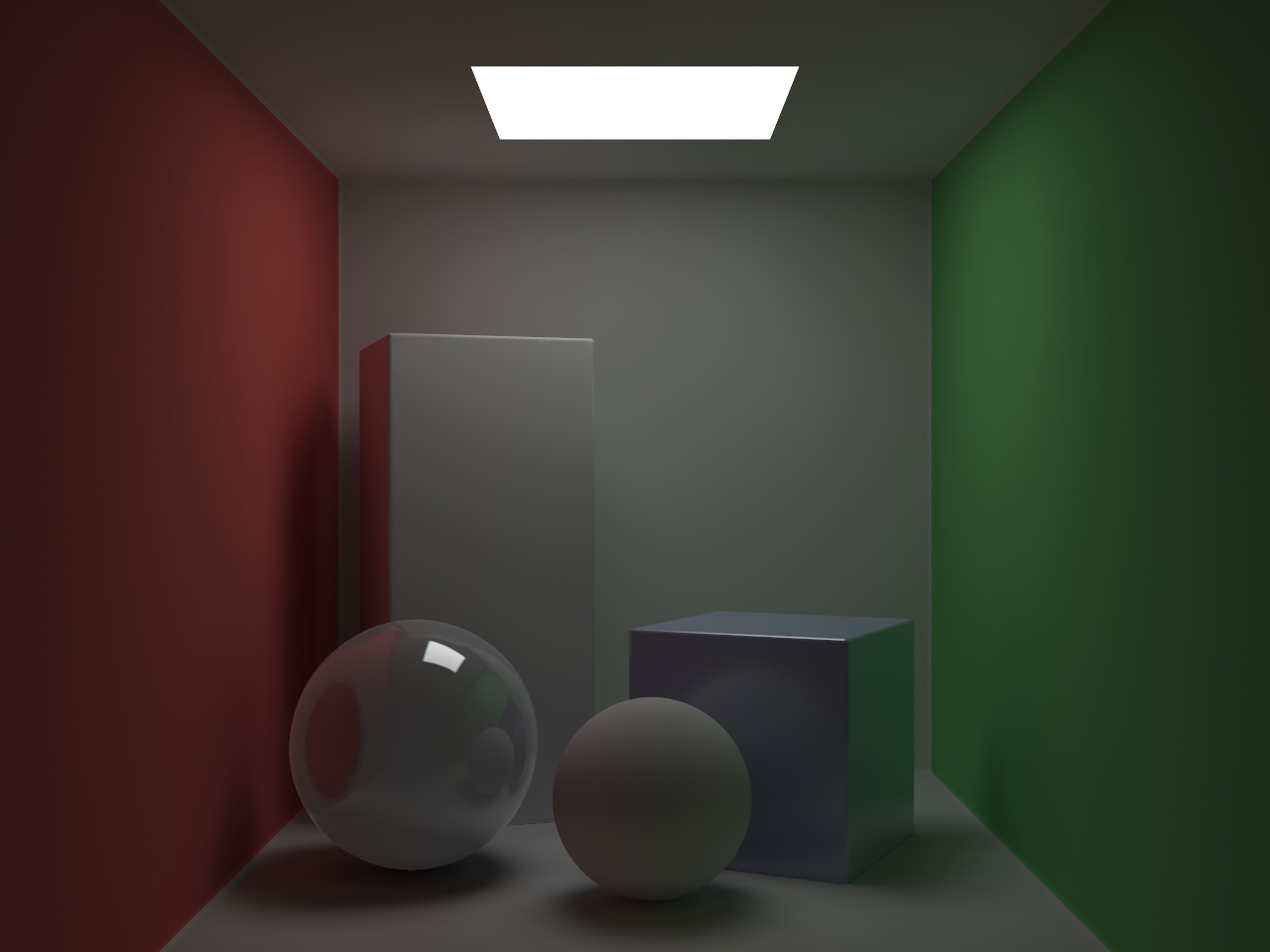

And the used Photon Map, which rendered in 18 seconds:
Kray PM
Kray PM

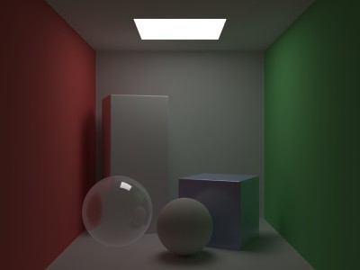

-I forgot to turn on "use transparancy" in LW for that render. It matters, but doesn't make that much of a difference. It goes from 2m 50s to 3m 10s. See:
Use Transp. added
Use Transp. added
-Also, I couldn't get rid of the "caustics" like thing in Kray. Even turning off "caustics" in the main options panel or setting photons to 1. Not sure why that is. Doesn't matters rendertime wise though.
-I read the userguide front to back regarding these things, and tried and tweaked settings for about 6 hours total.
-If I use "passes=1", I get very ugly splotches, especially on the ball. Can't seem to get rid of them in any way except upping passes so it finds and refines them. Increasing rays or decreasing distance did not help much.
-The PM is shown "precomputed", and is made in Photonmap mode instead of lightmap. Since I have no lights and that mode gave bad results.
-The LW render has a bit more splotches under the ball and next to the right cube. The Kray one has the ball less smooth.
-Both renders, but the LW has it most pronounced, have a very weird "glitch"? going on in the dark shadow left of the cube on the red wall. Do you see how it becomes more bright there for some reason, with a sharp edge? odd..

Got rendertime down to 3m 39s, but setting min distance to 100%. It made hardly a difference (200% makes the touch shadows blur out though). So slowly getting there :)
On the whole I like the Kray render better, just wondering if more can be done.. Next step of testing will be much more blurred reflections in the scene and animation with moving objects, cached. Edit: just saw that that can't be done, animated and cached.. hmm, bummer. I hoped the time interpolated mode allowed such a thing in some way.

Re: Cornell box testing, how to speed it up?
This is not good scene for test. Kray show much more speed in bigest scenes.
I will try prepare , maybe from evermotion.
In Cornell box is around 3 times faster then LW, but I know in big scenes with complex reflections, blurr etc this difference can be more bigger with more biger quality :) It is imposible compare LW engine render with Kray render becouse it is big tehnology space between both :lol:
Of coarse tonemping from Kray kill everthing around (I mean LWF, reinhard ) .It is perfect.

Could you upload the scene that renders it in 53 seconds like you have there please?
Would be interested to see how you changed it.
It has more blurry contact shadows and some light leaks on the bottom of that right cube, but over all it looks fast and nice.

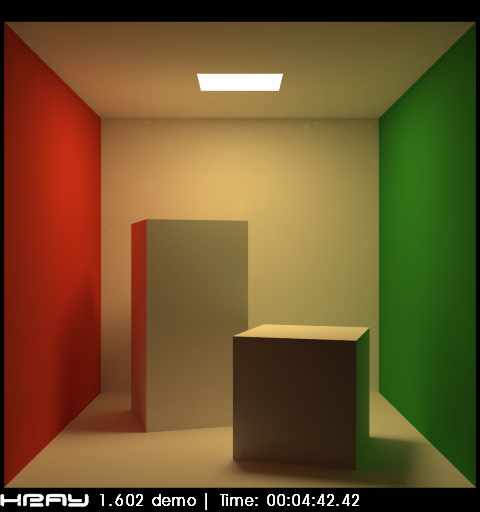

wow, the Cornell box! I made this scene around 2001 (?) to test it in Arnold and Messiah:render. FPrime was not born yet, that was released March 2004. LW GI was very poor for this sort of scene until LW9.2 much much later.
In december 2005 I had a go with the just released kray 1.6 demo. Time flies when you are having fun ;)
Will load this scene in kray 2.0 and see what happens, this one closely resembles the original Cornell photo, yes the original is a photo, not a render.
I made my scene from this data: http://www.graphics.cornell.edu/online/box/data.html
Now see kray 4 years ago!! ;) time is on a AMD64x2 2.4 Ghz working on a single core, multithreading came in the summer of 2006 (after I whined to G for 6 months at least hehe)
trip down memory lane kray 1.6
