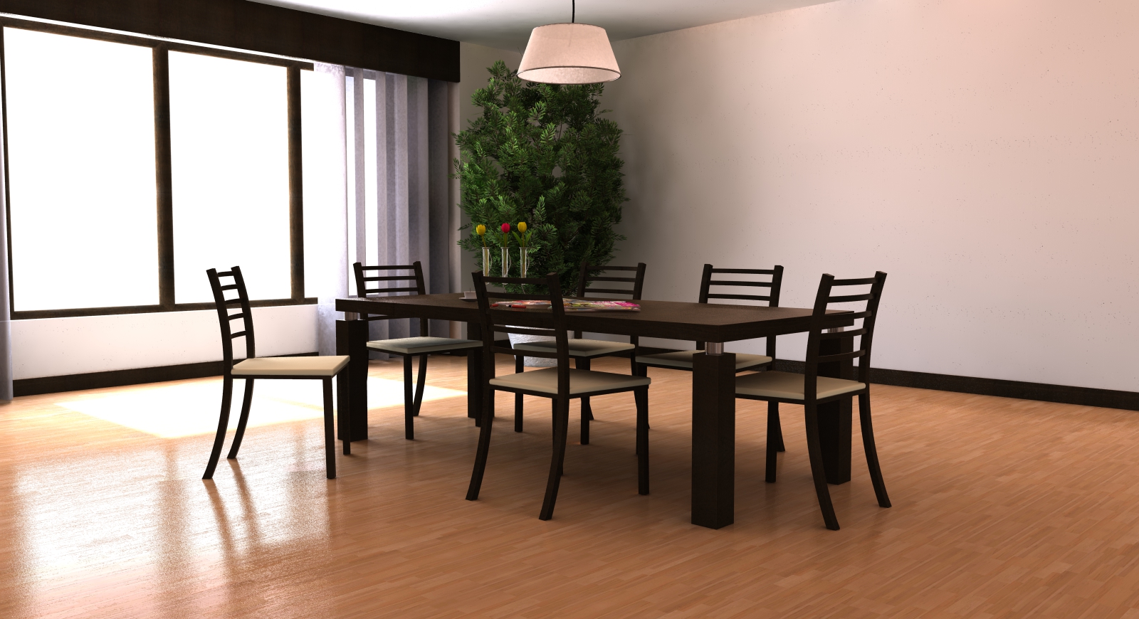

Hi, it's about for days (since I have bougth Kray) I'm doing some test.
This is the result... Unfortunaly, I have a predominance of red and yellow but i don't know how can I fix it.
Anyway, give me some comments and/or suggestions.
thanks to everybody.
Roberto
Roberto

The red and yellow come from your light and surface setup. What kind of light setup do you use?
I also see splotches in the corner - too low FG settings probably. Can you show them?

pretty nice start... congrats!
You'll have to do something about the splotches in corners and give it some textures, they are missing woodynes
the light is nice overaly. A starter tip - to make the light more soft and get rid of the overburned areas - use a photon multiplyer in lights motion plugins panel - try setting it up to 500 and increase a bit the LW light power.

About the light, I have used a spotlight (trasformed in an area light by Kray with "spotlight to area checked"). The light is 1 Km far from the objects and the color is 5500 Kelvin. No photonmultiplier used.jure wrote:The red and yellow come from your light and surface setup. What kind of light setup do you use?
I also used a texture enviroment with applyied sunsky procedural texure... The layer opacity is 350% and the bright is setted to 500% or something like that (I have the scene on my pc at office, now I am at home with the laptop.) The predominant color of sun sky is white/charming.
About the FG, I have used a custom parameter from 1000 rays to 2000 rays. 500000 photon in GI, N 600
About the surface setup, the problem is the indirect bounc from the floor. I have desaturate it at 100% with the apposite pluging... Before to use it, the render was completely orange.
At the end I've used Kraylinearworkflow setted to gamma 2.2 exposure 1.6
Tomorrow I'll be at office again and I'll send a screen of the parameters.

hi roberto, good work.
your test with kray are very good!!!
if you delete the red/orange effect to the wall i think is a good point for set kray.
in this scene you have used skysfere or textureenviroment?
light to the windows?
i know the answers and i know that you want a best lighting only one sun
light

I think 5500K looks too orange. I usually make it more yellow... but that's just metalats wrote: About the light, I have used a spotlight (trasformed in an area light by Kray with "spotlight to area checked"). The light is 1 Km far from the objects and the color is 5500 Kelvin. No photonmultiplier used.
Sunsky is not the best for light. Try skydome with image (HDR or LDR)...
You can decrease FG rays alot if you use local oversampling. Try adding this command to the tailer:talats wrote:About the FG, I have used a custom parameter from 1000 rays to 2000 rays. 500000 photon in GI, N 600
Code: Select all
prerender 1,2,0.01;gradients_neighbour 0.1
You don't have to set desaturate to 100% when your surfaces/lights are correctly setup.talats wrote: About the surface setup, the problem is the indirect bounc from the floor. I have desaturate it at 100% with the apposite pluging... Before to use it, the render was completely orange.
Do not change exposure in QLWF plugin. Leave it at 1.0 or your textures will get weird.talats wrote: At the end I've used Kraylinearworkflow setted to gamma 2.2 exposure 1.6

At with % of luminosity i should set my lumiball?
