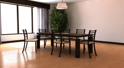

Hi, it's about for days (since I have bougth Kray) I'm doing some test.
This is the result... Unfortunaly, I have a predominance of red and yellow but i don't know how can I fix it.
Anyway, give me some comments and/or suggestions.
thanks to everybody.
Roberto

The red and yellow come from your light and surface setup. What kind of light setup do you use?
I also see splotches in the corner - too low FG settings probably. Can you show them?

pretty nice start... congrats! :) You'll have to do something about the splotches in corners and give it some textures, they are missing woodynes ;) the light is nice overaly. A starter tip - to make the light more soft and get rid of the overburned areas - use a photon multiplyer in lights motion plugins panel - try setting it up to 500 and increase a bit the LW light power.
good work !

jure wrote:The red and yellow come from your light and surface setup. What kind of light setup do you use?
About the light, I have used a spotlight (trasformed in an area light by Kray with "spotlight to area checked"). The light is 1 Km far from the objects and the color is 5500 Kelvin. No photonmultiplier used.
I also used a texture enviroment with applyied sunsky procedural texure... The layer opacity is 350% and the bright is setted to 500% or something like that (I have the scene on my pc at office, now I am at home with the laptop.) The predominant color of sun sky is white/charming.
About the FG, I have used a custom parameter from 1000 rays to 2000 rays. 500000 photon in GI, N 600
About the surface setup, the problem is the indirect bounc from the floor. I have desaturate it at 100% with the apposite pluging... Before to use it, the render was completely orange.
At the end I've used Kraylinearworkflow setted to gamma 2.2 exposure 1.6
Tomorrow I'll be at office again and I'll send a screen of the parameters.

talats wrote: About the light, I have used a spotlight (trasformed in an area light by Kray with "spotlight to area checked"). The light is 1 Km far from the objects and the color is 5500 Kelvin. No photonmultiplier used.
I think 5500K looks too orange. I usually make it more yellow... but that's just me :) For sun light also add photon power multiplier (~4).
Sunsky is not the best for light. Try skydome with image (HDR or LDR)...
talats wrote:About the FG, I have used a custom parameter from 1000 rays to 2000 rays. 500000 photon in GI, N 600
You can decrease FG rays alot if you use local oversampling. Try adding this command to the tailer:
Code: Select all
prerender 1,2,0.01;gradients_neighbour 0.1
and use FG rays min 100 max 500 or so. Also check that your spatial tolerance is small enough (0.05-0.1) and distance min around 50% max ~1000%. I also use B/D:0% and FG blur 1.0-2.0...
talats wrote: About the surface setup, the problem is the indirect bounc from the floor. I have desaturate it at 100% with the apposite pluging... Before to use it, the render was completely orange.
You don't have to set desaturate to 100% when your surfaces/lights are correctly setup.
talats wrote: At the end I've used Kraylinearworkflow setted to gamma 2.2 exposure 1.6
Do not change exposure in QLWF plugin. Leave it at 1.0 or your textures will get weird.
