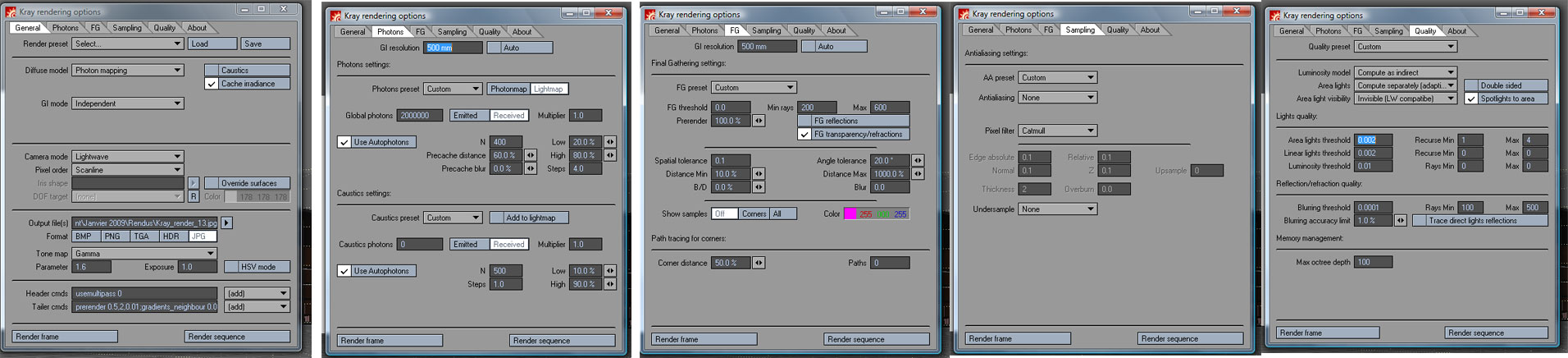

I got a problem with my last render, I tried to put some lumi-poly (up globes) at 2000% lum and I like the ambiance of the final GI but some artefacts appear on the image and I can't get them of, I don't know what to change on kray config...
here is the render and kray config...thx for helping

I'm using LW 9.5 64, kray 1.7 ob 8
my globe lights are 324 polygons each (i know maybe it's too much?), I put them on a different layer, with modifier krayPhotonNumberMultiplier (100000.0) and shaders krayIndirectRays (desturate 50, multiply 2) and kraySurfaceOptions (Visible, reflect, force)
thanks
thanks

Too low FG rays. Try min 400 max 2000 threshold 0.0001.
Also UPDATE TO RC1!

ps: So that having optimal settings for final gather, what maximum min & max rays do I can use? min 400 max 2000? Above? cause it still seems not to be enought according to the reslutls...

You can use as much as u want or time permits... More rays the cleaner the render. Add some FG blur too (like 4 or 8).mathewlp wrote:all right!
