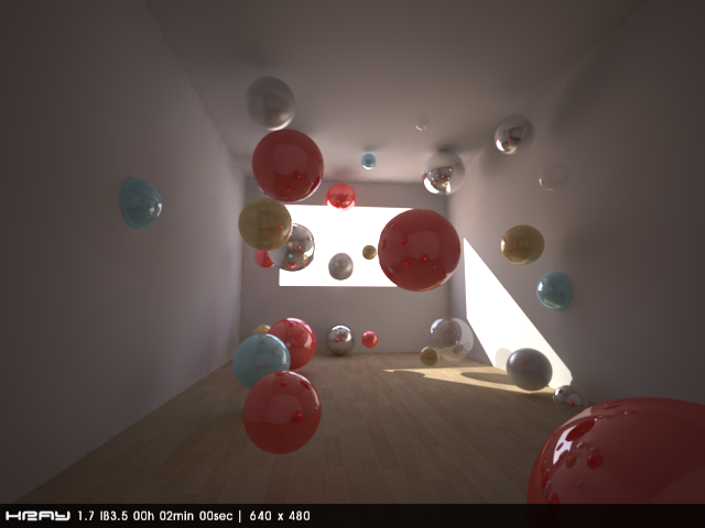

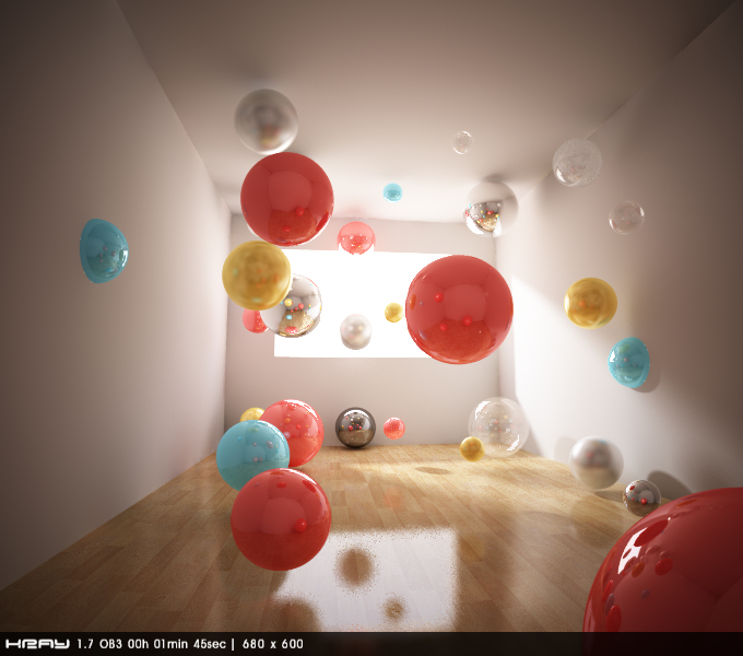

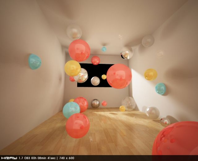

Hey testing a cgtalk scene. It's a wip so don't mind the quality.
Got one version with a area light in the window.
In another version I light up the room with skylight. This lights up the room but produce very weak shadows. Specially the sphere on the left on the wall. Any ideas how to make them stronger and still use skylight?
Photon multiplier is 1.0, 12 bounces. Both scenes has a sun light.

Yes, i have an idea!
Turn off CI (Cached Irradiance) and you should see the shadows.
otherwise if you want the speed of CI, keep lowering Spatial tolerance and Distance Min until you see the shadows. And I mean low, I've been using Spatial tolerance = 0.01 and Distance Min = 5.0% although I've never seen anyone on these forums go that low. I just need to have as many small shadows as possible! =)

Do you have a link for the scene? Also what settings are you using right now?

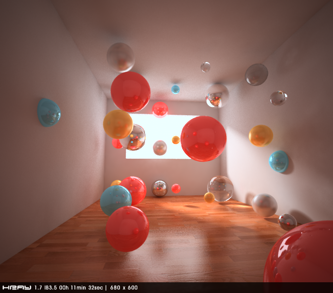

walfridson
Posts: 39
Joined: Sat Jul 01, 2006 9:34 am
Post by walfridson »
sure!
attached pic shows CI with spatial tolerance at 0.01, little bit better...

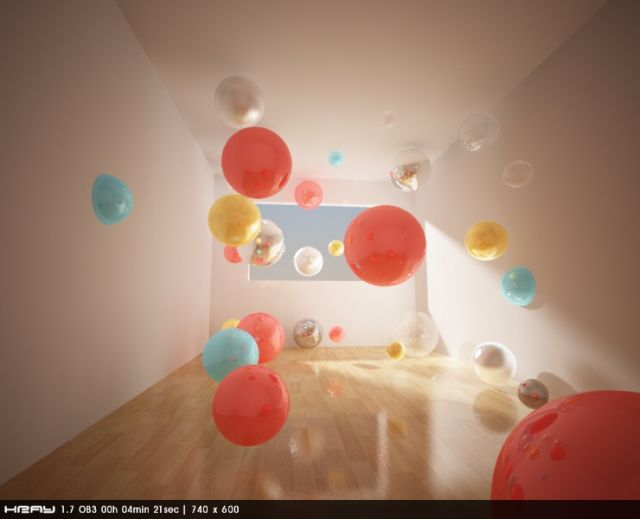

erwin zwart
Posts: 152
Post by erwin zwart »
after you gave me a link yesterday in IRC, I came up with this one. Your scene with one spotlight (converted to area) and skylight plugin.

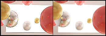

walfridson
Posts: 39
here's my result after some tweaking. hard to get nice result and low render times when pushing edge absolute :).. in this one i'm using 0.07
by the way if silvermannen, jure or any other betatester is reading.
when using catmull i get black lines:
using quadric gives me a whole black image after antibanding.
skype walfridson
Captain Obvious
Posts: 165
Location: London, UK
Post by Captain Obvious »
Catmull Rom is an edge sharpening filter, so you usually get lines like that around high-contrast areas.

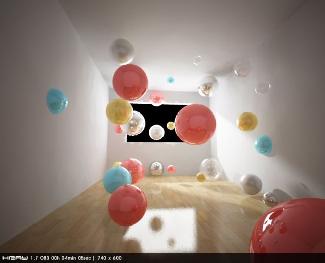

Posts: 453
Post by silverlw »
And another version with caustics enabled.
Luminosity modell "Automatic" enabled so the brighter luminous object gets rendered as "direct".
I like the precision of direct mode.
