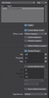

Re: HQ Plants
1. This noise can be also from reflection if you have, particularly from blur.
2. It can be from GI (low QMC shader)
3. It can be (I suspect) low resolution of animation and weak ant Aliasing.
4. It can be (I suspect) High video resolution and good Anti Aliasing also ...but sadly still.
...but sadly still.
Apparently I have no solution for that. Only post process fore example Denoiser II in After Effect. I know problem and it will be solve in K3 by let`s say dynamic AA. New AA engine in K3 will have detection: where must be strong AA and where weak. Anti Aliasing is connected strongly with GI , and having new engine automatically we will have faster AA.
Try put on the leafs this setup: this is minimum. Also do not add reflections on leafs only specular.
 ...but sadly still.
...but sadly still.Apparently I have no solution for that. Only post process fore example Denoiser II in After Effect. I know problem and it will be solve in K3 by let`s say dynamic AA. New AA engine in K3 will have detection: where must be strong AA and where weak. Anti Aliasing is connected strongly with GI , and having new engine automatically we will have faster AA.
