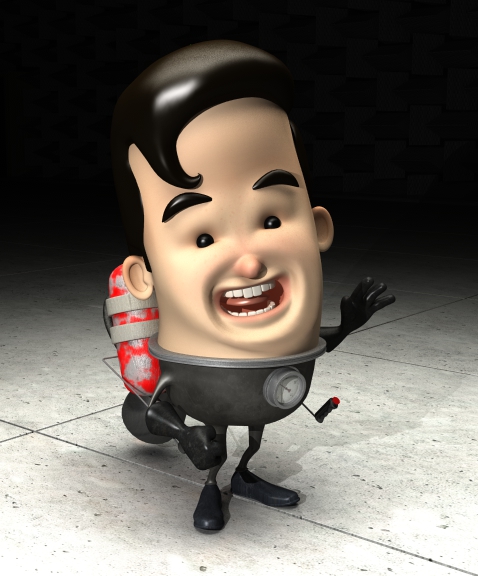

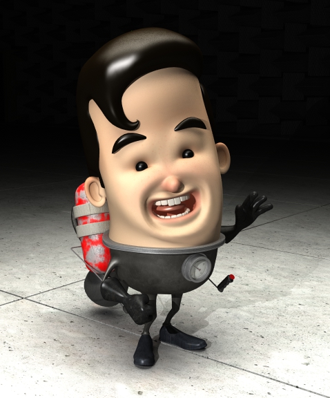

Here is the scene: This is the figure, there will be several playing around in the scene. I just hope that I dont need to render it on time interpolation. I really want to use my farm for this.

Re: rendering animation on network - GI settings
You should be fine with baked solution. It's mostly direct light shadows that will be changing around... Nice character!

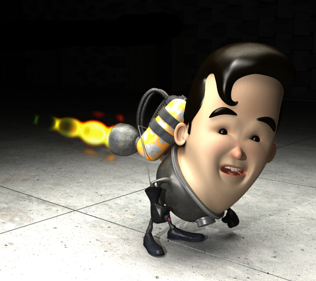

Thx! Here some other poses:
We're ganna change the hair just a bit. The flames are just a volumetric light rendered with lightwave native renderengine. Maybe we will add some particels in the flames.
fabian...show the anim!!!
great work!!
						great work!!

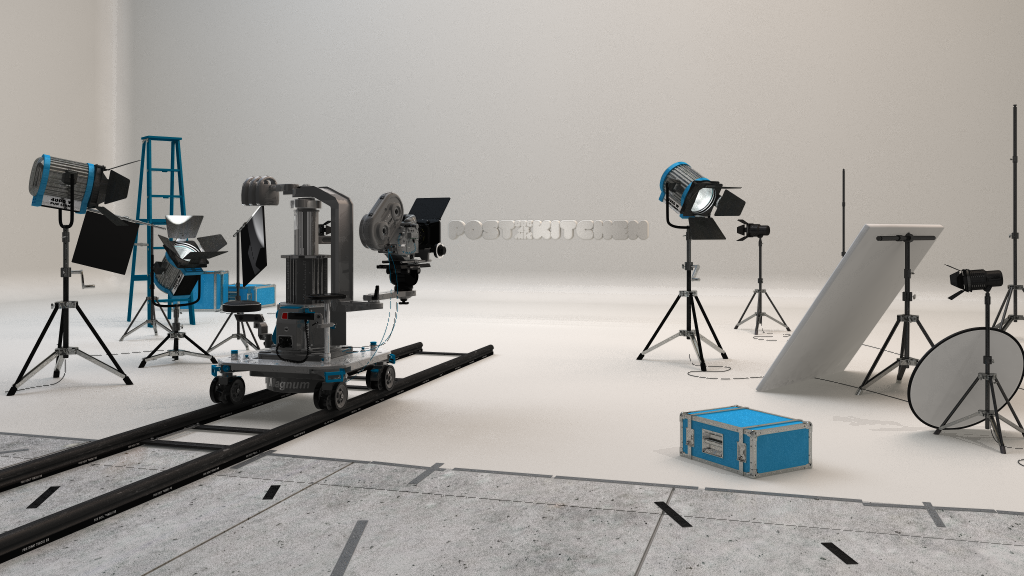

The new setting of the animation:
