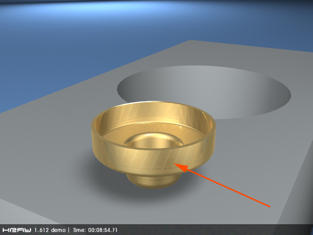

Hello everyone,
New here and my 1st post.
I have attached an image which rendered with some funny stuff. The arrow in the image points to where some pattern appears that should not be there. Does anyone have a clue why this is happening?
I'm using Kray 1.6 Demo. I briefly went through the tutorials but still don't have a grasp of it all. Anyway, could someone help me out.

Rendered with Kray 1.6

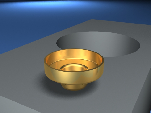

Rendered the LW Renderer

It's hard to judge from the images what it can be. Maybe it's smothing errors depending on to high smooth angles? Kray can be a bit picky about that so try lower from 89,9 to 30. It's hard to judge from the images what it can be but also look at your arealights settings raise arealight quality from min0 to min1 or 2. Can you share the scene/object so we can find out?
Hmm it looks like a geometry or smoothing problem. Have you checked for 2 point polys?
If you post your scene I could quickly locate your problem...
About light rig: it depends on what effect you're trying to achive. Setting up for KRay is easier than LW because you can use GI to light your scene (no need for bunch of lights).

I tried setting the smoothing angle to 30 and it doesn't fix the error.
Wait a minute......., wouldn't a smoothing angle problem also show up also using lw's renderer???

It seems to be a bump map that's causing the error. I removed the map and Kray renders it just fine.

Hi Noble!
I have looked at your scene and found out that almost everything is "wrong" atleast for Kray! ;-)
The 20x30 meter large room with a tiny cup in the middle will cause Kray to try shoot photons everywhere in the room and to fill that up and at the same time maintain some detail at your cup, you have to shoot alot!
I totally removed your backdrop/room and replaced it with a basic bluish colour,turned on lightmapping (to get photons from the backdrop) and rendered the scene at a fraction of the initial time.
Another thing i noticed was that the bumpmap was applied as UVmap in surface editor but when i looked at the object in modeller no uvmap was found. I mapped the bumpmap as cylindrical instead just to test and it worked as it should.
Why use so many arealights when you can use imageworld and an hdri,lightmapping and light the scene with radiosity? Is your goal to only use raytrace? Try radiosity since it renders at about the same time.
I hope this will help you further to understand Kray and dont hesitate to ask further questions.
