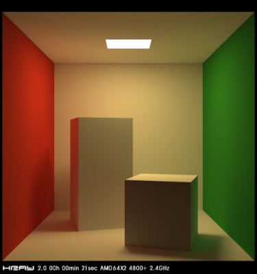

I tried a load-and-render of the original 2006 LWS (also included in my attachment) and saw that the rendertime was about 15 secs now (!!!?). So kray has become much MUCH faster itself, even if you halve the original 1core kray 1.6 time because it now uses 2 cores unlike kray 1.6. The old settings do not give the exact same result (many code changes since then) so I did some changes to bring it to 2009 standards:
AMD64X2 4800+ 2.4GHz dualcore

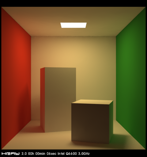

After that I rendered it on my present computer (Intel Q6600 3GHz quadcore):

What strikes me most now, is that this scene does not use any QLWF and tonemap blending and it just looks right in bounce with just gamma 2.2 on the endresult. But there are no textures to mess up and the colors of the walls and lamp are reverse engineered by me based on the original. Please all have a go with PM instead of LM and using lumi quad instead of arealight and QLWF and tonemap blending with other surface and light settings to see what happens. Enjoy!

He he "dot the i" 6 sec. :lol:
Re: Cornell box testing, how to speed it up?
...and my 3 sec....
