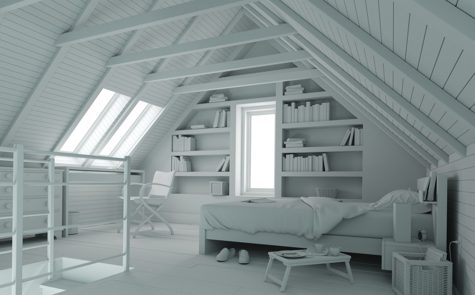

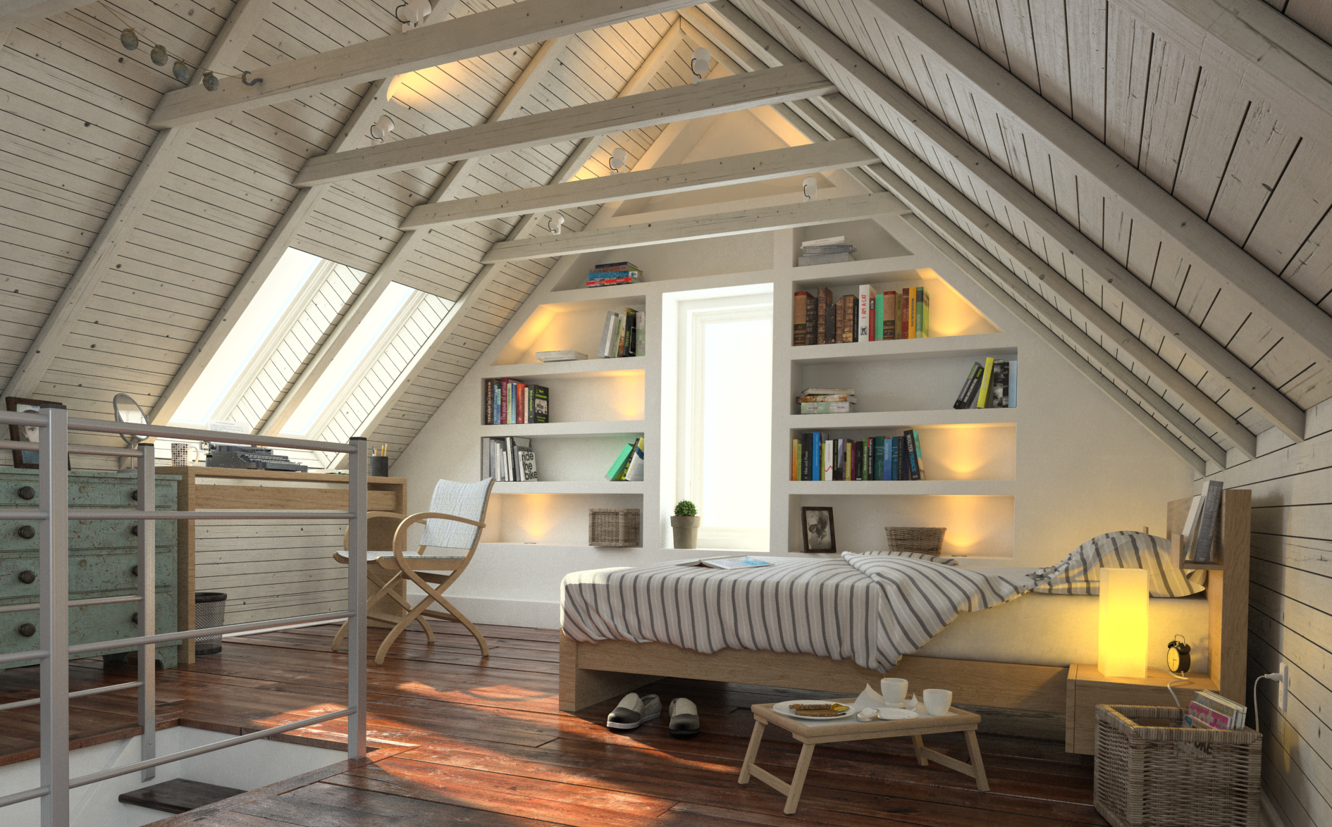

I will post also render from KRay 3. So far I'm not able to reach good quality.
First render with materials is from VRay (just for information). My plan is to try to reach a similar result with KRay.
You can buy this scene at Evermotion - Archinterior vol.35.

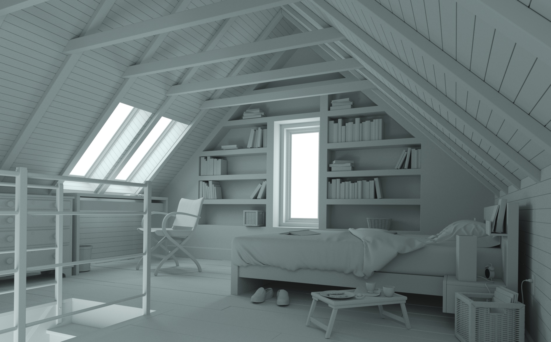

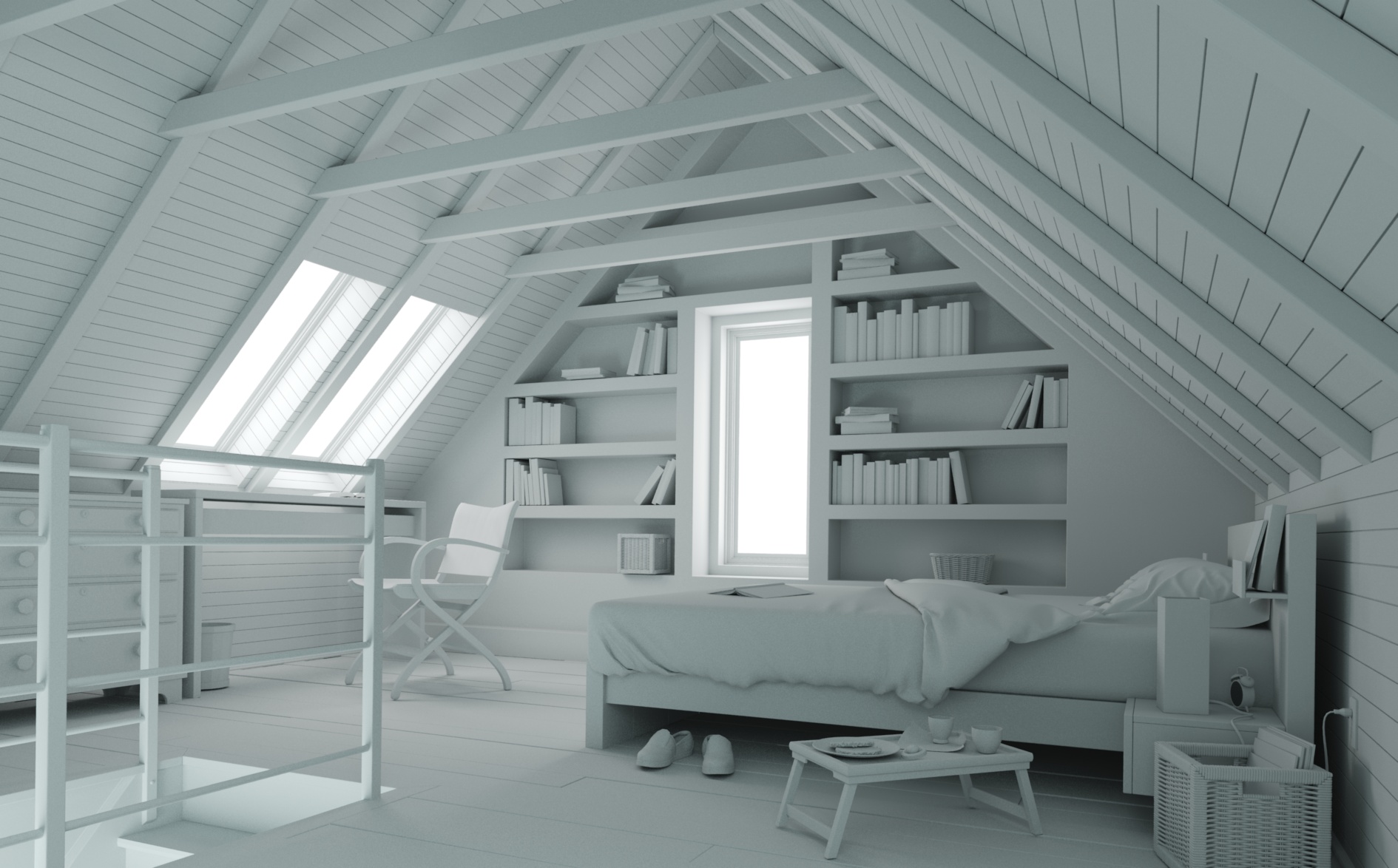

You need Light Portals in windows - that's why is long and this is normal. Photons from outside (only background light sources are the most technical difficult to render - photons has really huge problems to feel up scene inside - that's why you see noise. Noise means NO INFORMATION or NOT ENOUGH INFORMATION)cruisermori wrote:K3 render - 1h16min
Still a lot of noise.
We do not have Light Portals becasue....we do not need
K3 has perfect Photon Map - there is nothing on the market even close to compare with quality PM in K3.
Simple add to scene LEM in places where are windows.
Even in Path tracing engines they use Light Portals to speed up render or reduce noise.
On Dual Xeon (you used perhaps i5/i7 CPU also) this scene with this resolution should be in 2-5 min in override mode.

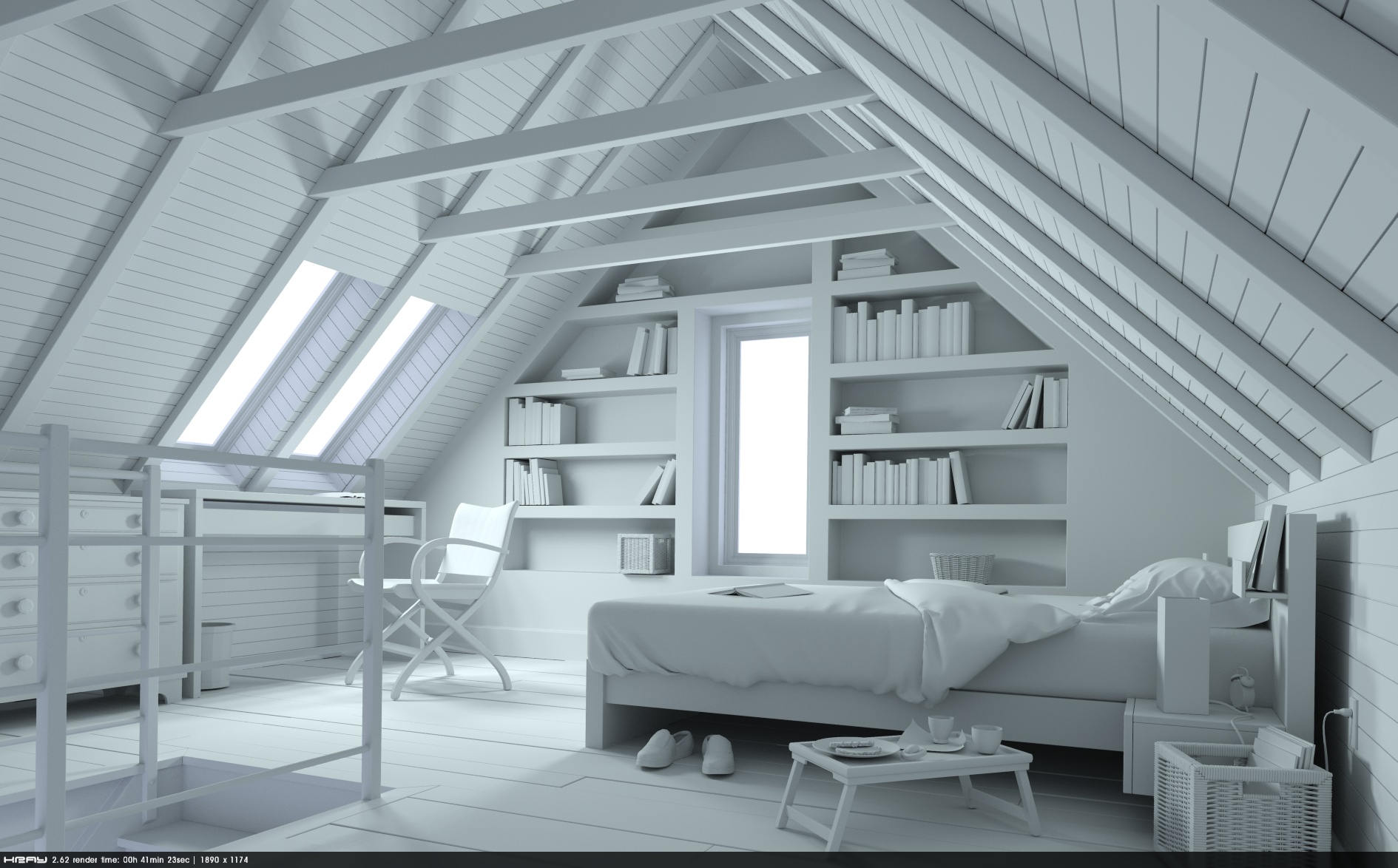

I'm confused Janusz. First you say we don't have light portal because we don't need them, and then you say to put LEM rectangles in the windows, which are, basically, a very limited version of light portals, since most light portals actually implement the direction of direct sunlight and skydome blueish color.
Sooooo... How do we get good PhySky interior lighting with the efficiency of light portals in K3?

Always you need support light in windows - although you have real time tone map with clip bright/dark regions. But this has a little no sense becasue if you do not use support light (light portal or LEM) you get a lot noise inside.
Why in other software they use only background light? Simple: becasue they need speed up render (is freaking noise of course) but the have choice: use one fill light ans Sun (so only two light sources) or add extra lights in windows and extend render.
For K3 is doesn't matter 2 lights or 20: almost same speed.
Is enough to see Corona or Fstrom renders: simple rooms with small amount light sources. of course they are great Engines but ...very slow.
Actually Corona is really fast but I see also errors in GI there (G. info: "approximately Path tracing Interpolations...or something that)
Corona has good features: real time tone map, real time post process, shader system.
Light Portals has only one purposes: to collect photons from one side and shoot them to other.
Without them Photon map is highly unorganized. Unorganized Photon map create noise (not enough information for next sampling stage).
They shoot "parallel" photons to other side (in our case interior). Light Portals helps poor written Engine Renders to handle this mess what is inside interiors lighting by external background lights. Details how Light Portals works - mail to G.
With good PM solution (K3) you do not need them - easy life: copy/paste windows glass create LEM surface and hide them. target of that is support light from outside.
People make huge mistake using Area Light outside interiors, just behind windows - IT HAS NO SENSE.
You can put Area Light instead of LEM panels but how it is uncomfortable to do it! and effect is almost the same.
Of course light is a bit artificial becasue this ADD color instead transport Physical gradient to inside. But when they mix together (bluish LEM and Physky) it is slightly noticeable.
LEM lights in K3 has Area Light behavior but speed of luminosity!. This is very unique.
Light portals are trouble makers - crashes, long calculations, not enough collected photons generally. Personally I do not like them.
Simply create LEM (200-500% luminosity) , hide them , put bluish color (use Kelvin LW scale). Easy to control, ultra fast render, no noise, no "nuclear" light from outside (after that we do not need bend tone map too much), no need Area Lights (physical lights are raytracing renders lights - always long to calculate)
If you need perfect Light in interior - use Area light instead LEM. K3 has new engine for them: simple perfection.
Is no problem for single room with 1-3 windows. You will get really fantastic and realistic shadows. But K3 LEM are not so far from them.

Thank you Janusz for help. I forgot to switch on LEM panels in the windows. New render took about 48 minutes. Much better result.
