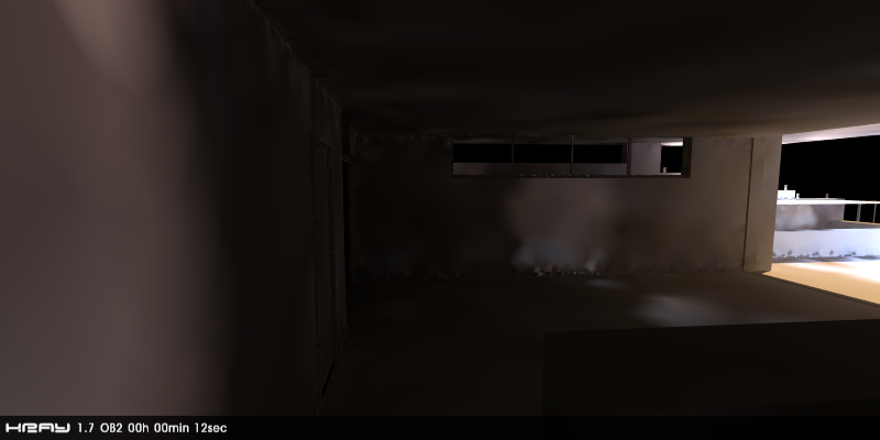

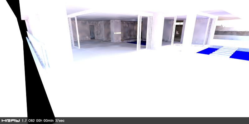

I'm doing an animation and experiencing a weird problem, It seems that kray is not adding new calculations to the Shared GI file when it goes to a new frame. Look at the attached images for example.
Does anybody know what I'm doing wrong or whether it is a bug?
Thanks
NiGMa
First Frame = no missing calculations
Later Frame = missing calculations
What are your render settings? Looks like there are not enough photons hitting in last frame.

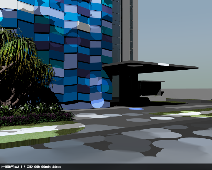

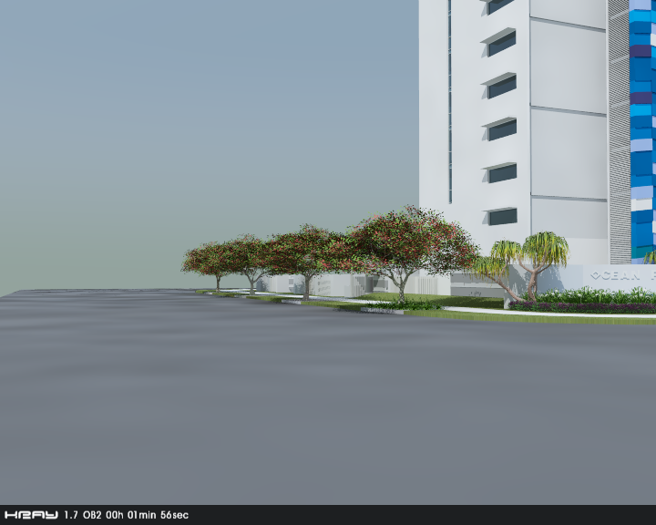

Im trying to "SAVE" out a GI File so I dont have to calculate FG, Photons, CI every frame.
As a test I have a 200frame animation, I set layout up to render 0-200 in steps of 200, which results in two frames being rendered, when i hit "render sequence" in kray this is what happens:

I found the problem. It was the skylight.p texture environment I had on. If there is an animated envelope in skylight.p thats when the error occurs.
Now I can render animations.
I wonder if anyone else has had this problem? I thought skylight.p was popular?
