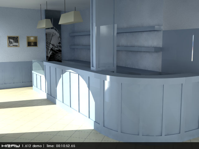

Hi,
I've made this simple scene for trying to understand how can setting the parametres for best result.
... sorry for that usualy questions :oops:
How can I increase the quality of the render and how can I manage the antialiasing parametres for increase or less the quality and the time render ??
This is the settings that I used after some tests and see in other post.
Global photons: 500000
N: 6000
Paths 1
FG threshold 0.01
Min rays 100
Max 800
Spatial tolerance 0.2
Oversample 500%
Stochastic
Threshold 0.01
Rays Min 20
Rays Max 60
Undersample 32
Thanks in advice
Fulvio
try FG max rays 2000 and for Antialiasing FSAA grid 3.
But if you realy want to get faster render times, better quality and easier setup you should get yourself 1.7...

jure wrote:try FG max rays 2000 and for Antialiasing FSAA grid 3.

Yes understandably... The problem is that 1.612 is very very hard to compare to 1.7 and doesn't do justice to it at all...
