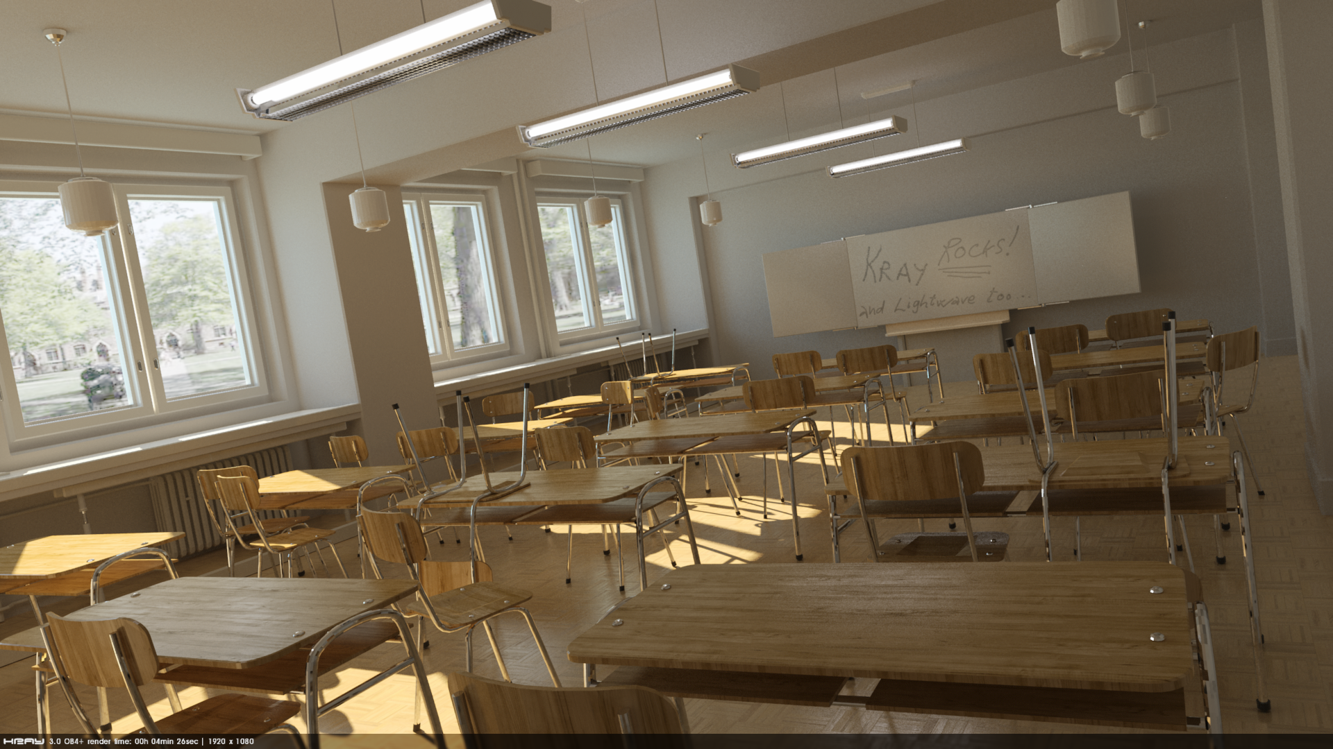

Old classic scene in new Kray OB4+ with visible new small bug (smoothing) but finally fixed corner errors:

Simple animation test. Some splotches, but very fast anyway. 3-4 min/frame

This error is that bug which we hunt continously. Is very random like you see. Theses are not "splotches" but "random hot photons". Photon map should be static so no flicker at all...in this department Kray is the best.

Yes, I understand. But I'm still concerned about the noise that remains after rendering with almost any settings. Even the highest settings do not eliminate this noise. For example, in Arnold (I know it better than the Corona or Vray), you can achieve an almost complete disappearance of noise, which is proportional to the increase in rendering time. In K3, the time spent on rendering very weakly affects the noise.
I mean rendering in QMC mode or Pathtracing. The caching mode of photons does not work for me - LW falls every time.

Just put 2000-3000 rays.
There is small problem in K3 with high level of Rays: it doesn't affect reducing noise. I have to check it again and talk with G.

Now it came to me!
You render frames with QMC?
If yes then of course you will get flickering ! because each frame is render with new Photon Map solution. This is normal. To avoid that "problem" (you need STATIC Photon Map) you need to generate Photon Map. This takes a few second and has small file. I doubt it works in K3. In K2 of course:
