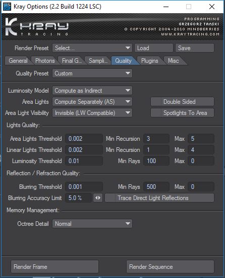

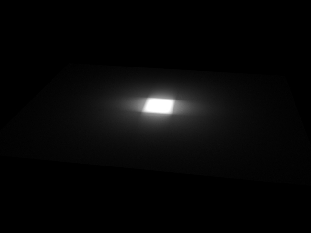

Here setting for minimum quality for Area Light:
Here maximum quality (over that is unprofitable raising amount of rays):
I suggest to use QMC system and LEM lights. In this moment the best option for rendering.

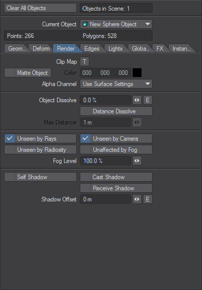

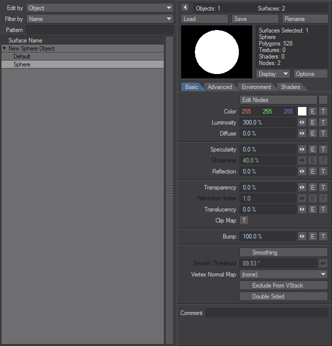

Re: Anti aliasing area light

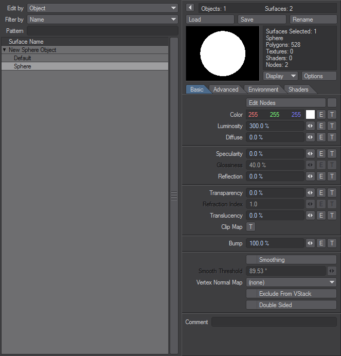

Here you have settings.
LEM:

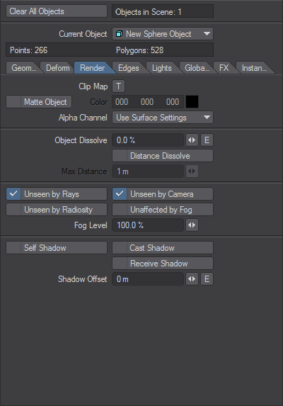

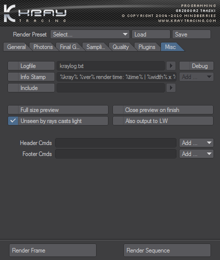

If you want hide LEM in scene (only light will be visible, like Area Light):
1.Select in Kray GUI Unseen by Rays Casts Light
2.In LW select Unseen:
Your LEM starts be invisible, giving only light.
