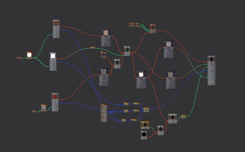

This effect took 6 textures in Nodes: and perhaps he use same system (of course in his invented way in other software) but idea is the same: I show this because pre processing is very important. You can not put just one texture and expects good result: IMPOSSIBLE

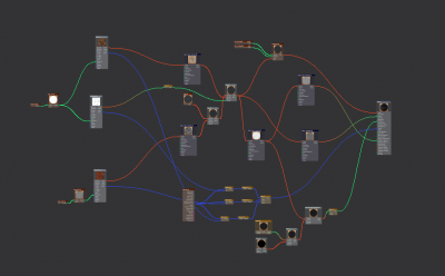

Hi Janusz,
1) What do you mean with pre-processing? I mean, what type of things do you do in pre-processing phase and what issues does this solve or affect? Is it mostly gamma precalculations?
2) Any chance we can get to see your node scheme?

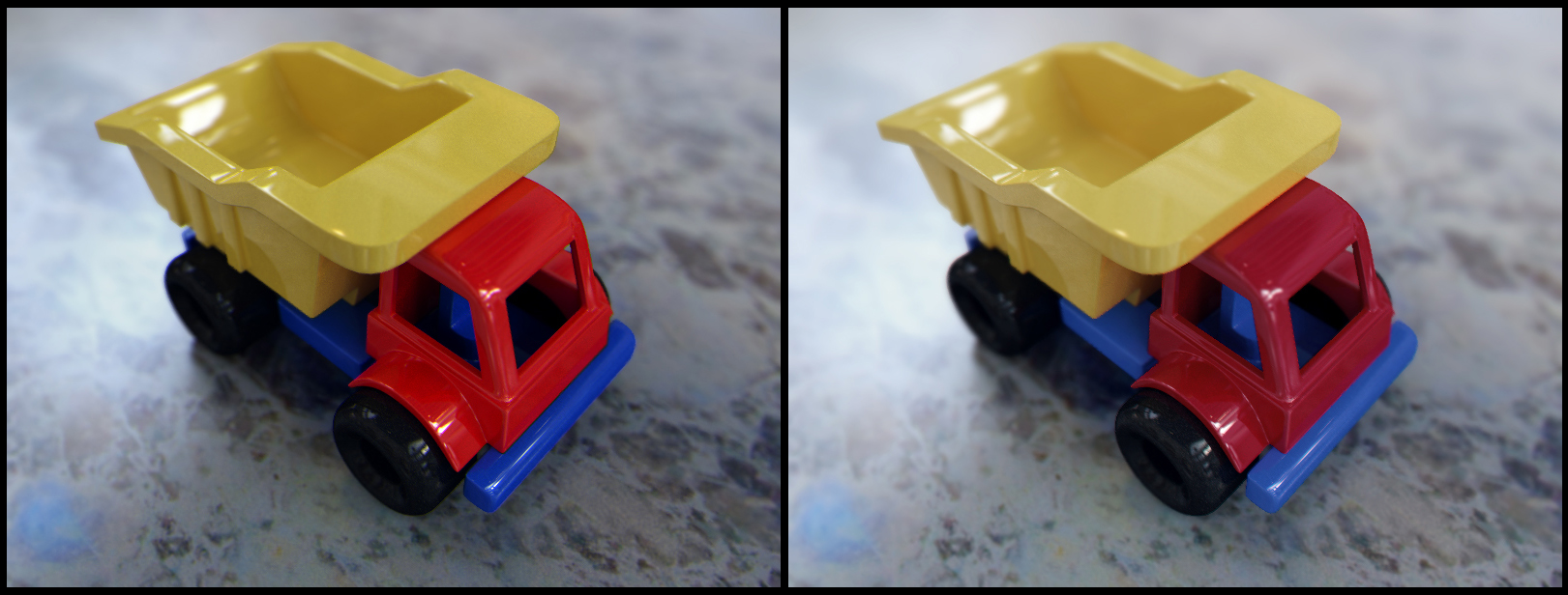

hehe this is useless option its cant give u the result what im told you about. i try it and know what kind of result you get. wait until i put render interior tricks u will see it cause i see area light in lw and kray read it as normal but if u add poly light u will get realistic light. from this one . u need to hide this lumi reflection from other surfaces i mean custom but you cant do it . cause if u check unseen by rays u will not get the reflection from lumi . i think the best thing it like option wich surfaces can read that lumi reflection or hide it from ex...... for exmple if u have chrom . chrom need to see this lumi light . and glass in window not. later im going to explain more further .thomas wrote:By the way: maybe I understand it wrongly, but you can hide lumi from reflection and have the direct light be casted in Kray using the "unseen by rays casts light" option!
the surfaces id i need it to get realistic color or nature color cause my render get more saturate raw.

this is simple exmple mixing light inkray . this atmosphere didnt need lumi light.

I'm sorry, I don't really understand the problems you are running into. Your little toy truck is something that can be fixed in two minutes within LightWave by just changing the color values, or in photoshop with very little effort, adjusting vibrance or saturation. I know that for some jobs you might really really want to use object IDs, but this does not feel like not one of them. This is even a great example for using the colorCorrection node!
Also, for good arch-viz I think the procedure is really simple: model all the "real" light sources, so they can be reflected in EVERY surface (so that means glass as well as chrome), potentially attenuate or strenghten these using photon multiplier, and add area lights or luminous polygons to fill in areas that might be too dark. For the few situations where you want to have a lumi not reflect in something some simple photoshop composition work can be a lot simpler than setting up everything in passes and with visibility flags.
Like I said before, I'm not trying to be critical, but it feels like the problems you have can be solved easily, but you just want them to be solved in a very specific way. I might be wrong and seeing things too simplistically because I don't run into those issues.
In the last image, what is not working the way you would want it too work?

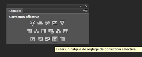

Well, nobody is saying that Photoshop doesn't have its use in 3D work, but honestly, half of these can be recreated without a lot of trouble. Color Node, ColorTool, Invert node etc... Give Janusz 10 minutes and he probably recreates all of these in 10 minutes, with more flexibility than you have in Photoshop.
Still, I have to repeat myself: I don't really see the limitations that you see in LW + Kray, apparently.

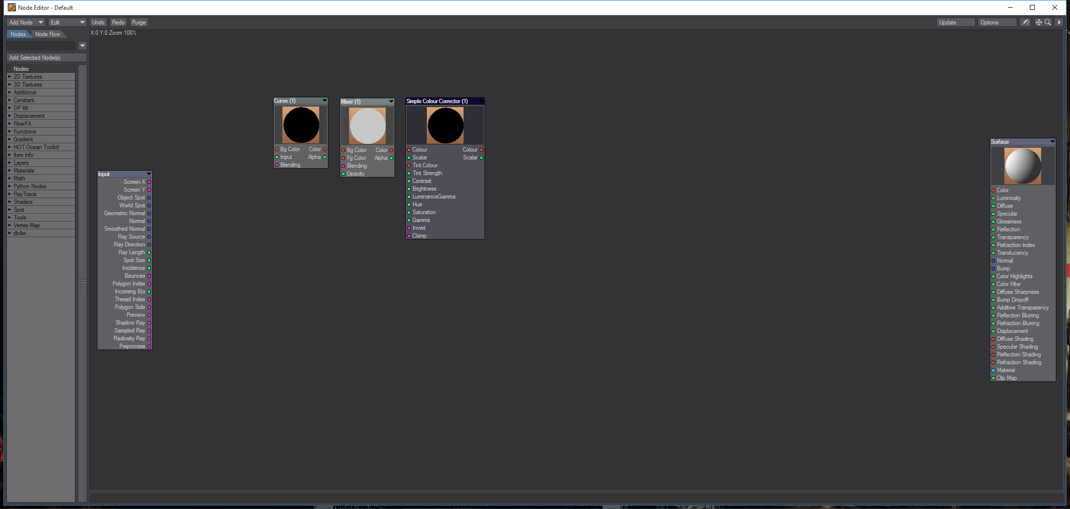

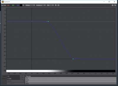

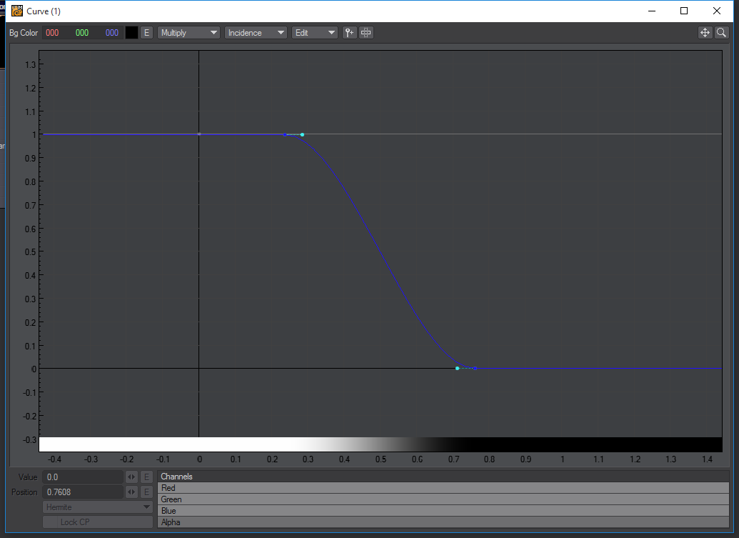

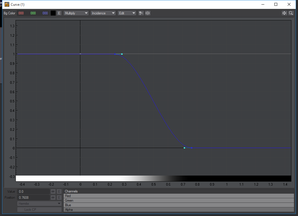

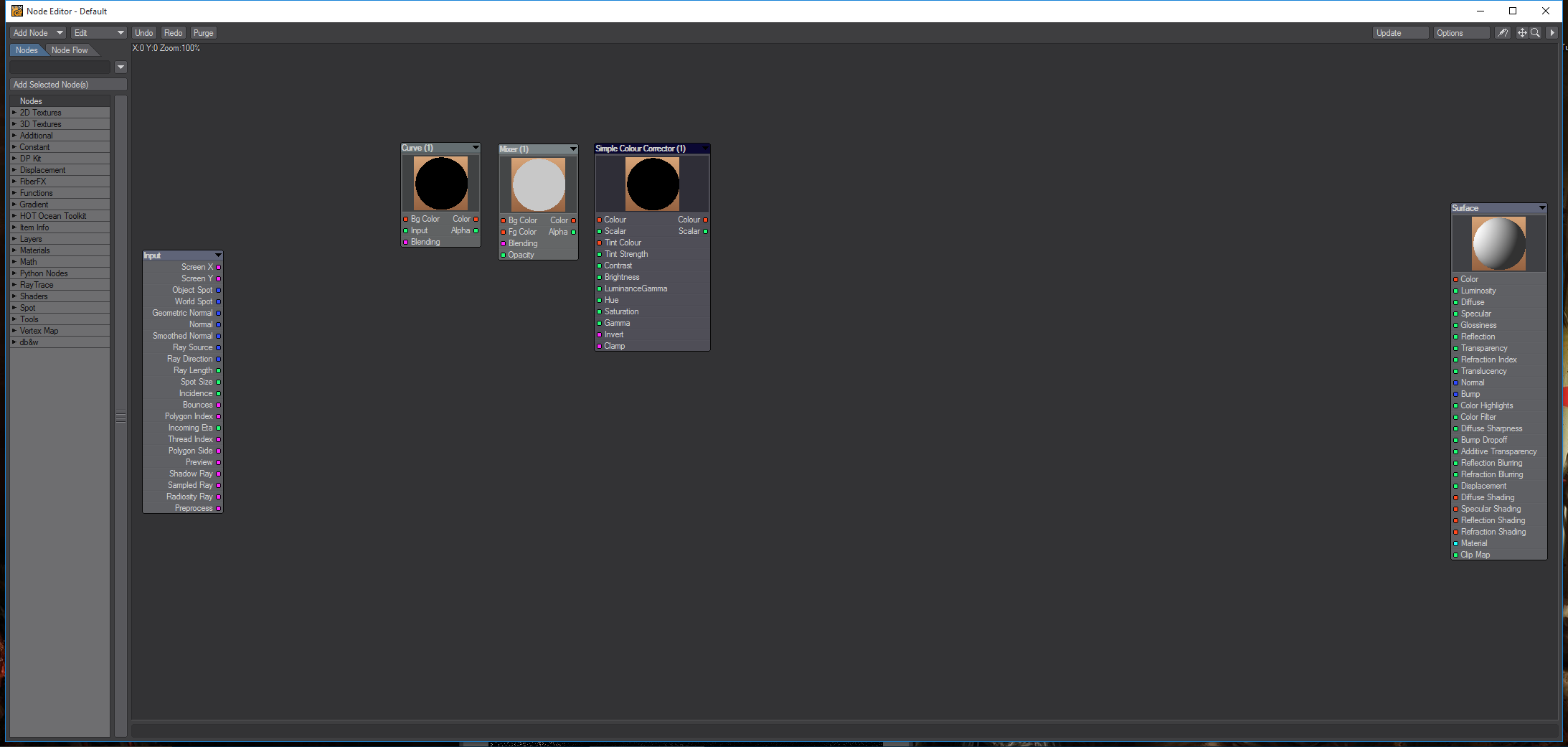

Here small information about pre-processing:
Curve Node (my favorite) huge potential!
Example blending with multiply and Incidental Angle: You can use it as:
- blender of two materials in mixer (curve allow you blend two input materials in very flexible ways)
- Incidental Angle
- you can Inject material into Curve and blend it (all Photoshop blends)
Mixer and Simple Colour Correction: Mixer allow you to mix material source or colors in many ways. Curve Node connected to Opacity make nice combination (I use this the most)
Simple Colour Correction allow you prepare from one texture: reflection map, blur map, diffuse map, etc.
Also you can correct textures before color input because most of them are too bright or too dark or to much saturated or you can change texture by Hue color of texture (for example you need wood more reddish or more yellow)
All these above save a lot time, make renders easier, more realistic. By a few clicks you can make professional surface which are much better then standards.
