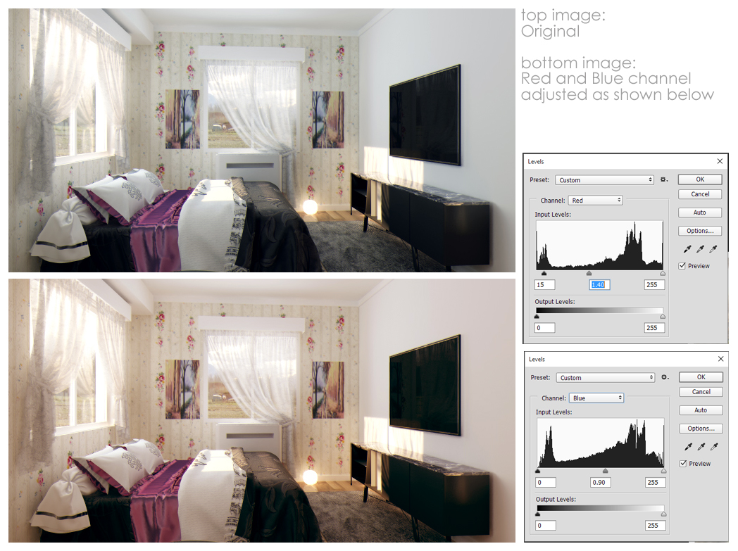

Hi Lightwave3d,
Too much details? No way! It's super-easy and a great tool!
When you use Levels globally you can set the white point, mid point and black point to adjust contrast, right? I mean by moving the little triangles in the Levels tool. Okay, so when you do this globally you can adjust the contrast for the whole image.
Now, when you do this separately for R, G and B you can adjust the contrast and color grading in a way that makes your highlights neutral, your midtones more warm and your shadows more blue or green, which is a bit how interior lighting works.
At first it is a bit tricky, but the easiest way to learn how to use this is to only move the middle triangle, for the mid point, on the red channel. This allows you to make the mid-tones warmer or cooler. Do use this too much or things start to look fake or forced, as with all Photoshop effects! When you feel comfortable using this you can combine changes to the midtone of the Red channel with changes to the midtone of the blue and/or green channel, and then finally you can learn to use white point, mid point and black point separately on all three channels.
I'll make a separate post using one of your images to demonstrate this technique, if that's okay for you?
Re: quick test
Here you go, I just made you an example, based on a recent gallery picture you posted!
