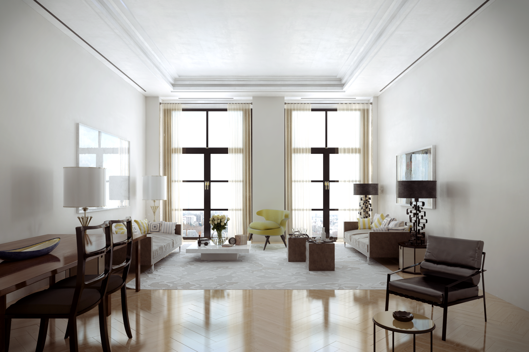

room new light test
room new light test
Here new test with some new ideas. I did not want make exactly the same effect (it was no target). When I render this in V-ray I was terrified with speed render: 11 min for resolution 600x400 pix!:

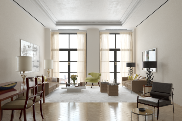

RAW:
...it was no way when Kray could be even close to this score (this is quite heavy scene with many V-ray shades) But with Nodes (especially with limited reflection) it was possible to get almost the same time :wink: ...also in V-ray they limit recurse for reflection so is not "cheating".

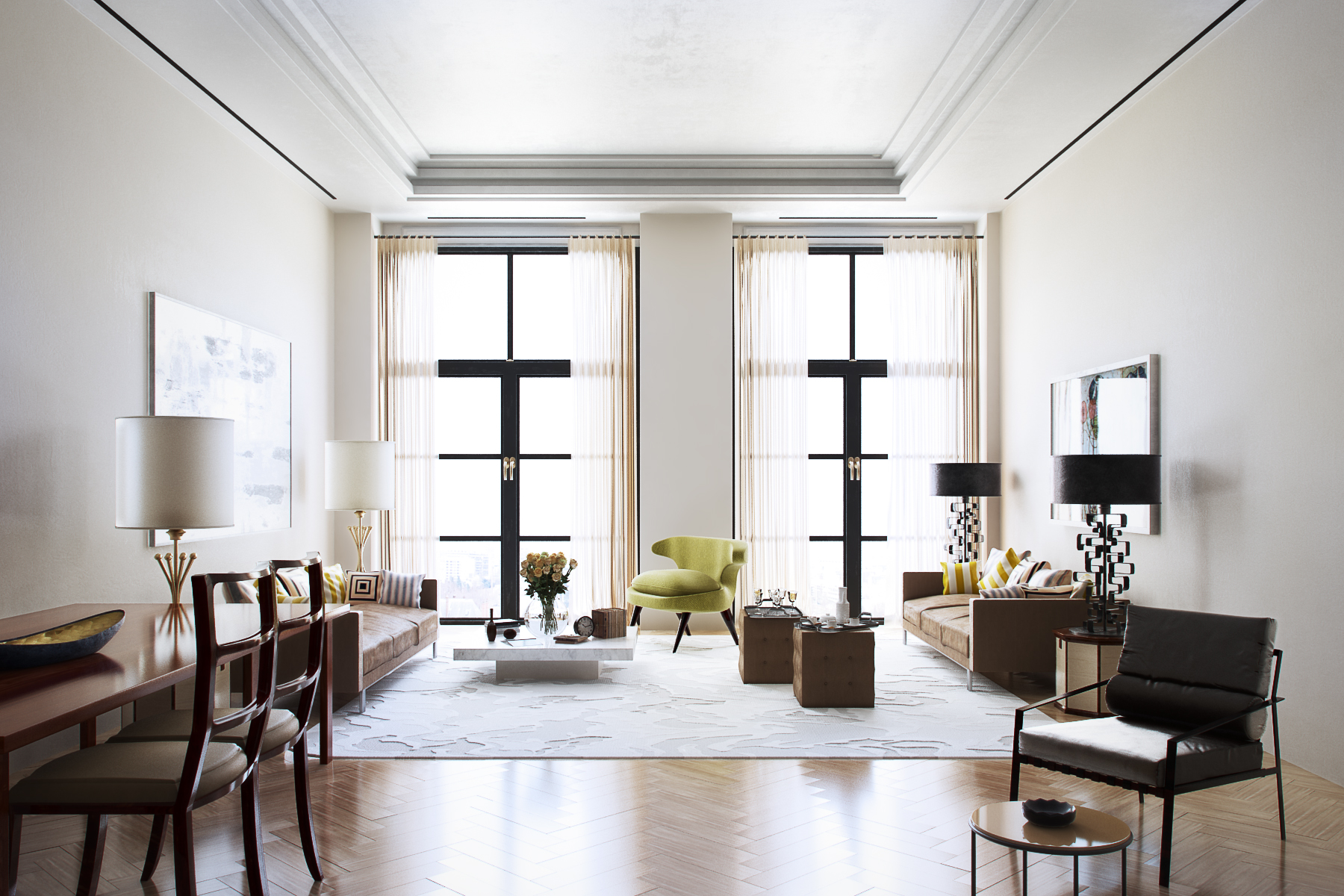

HiRes V-ray with post process:

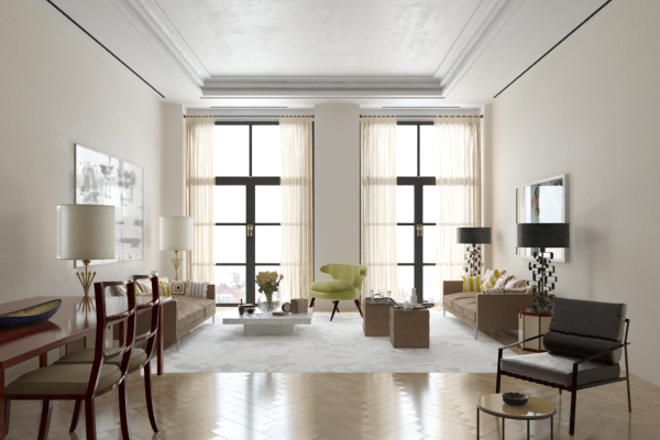

Kray render 1h40min with post process:
One more think: my render has no specular at all so all reflections are physically correct.

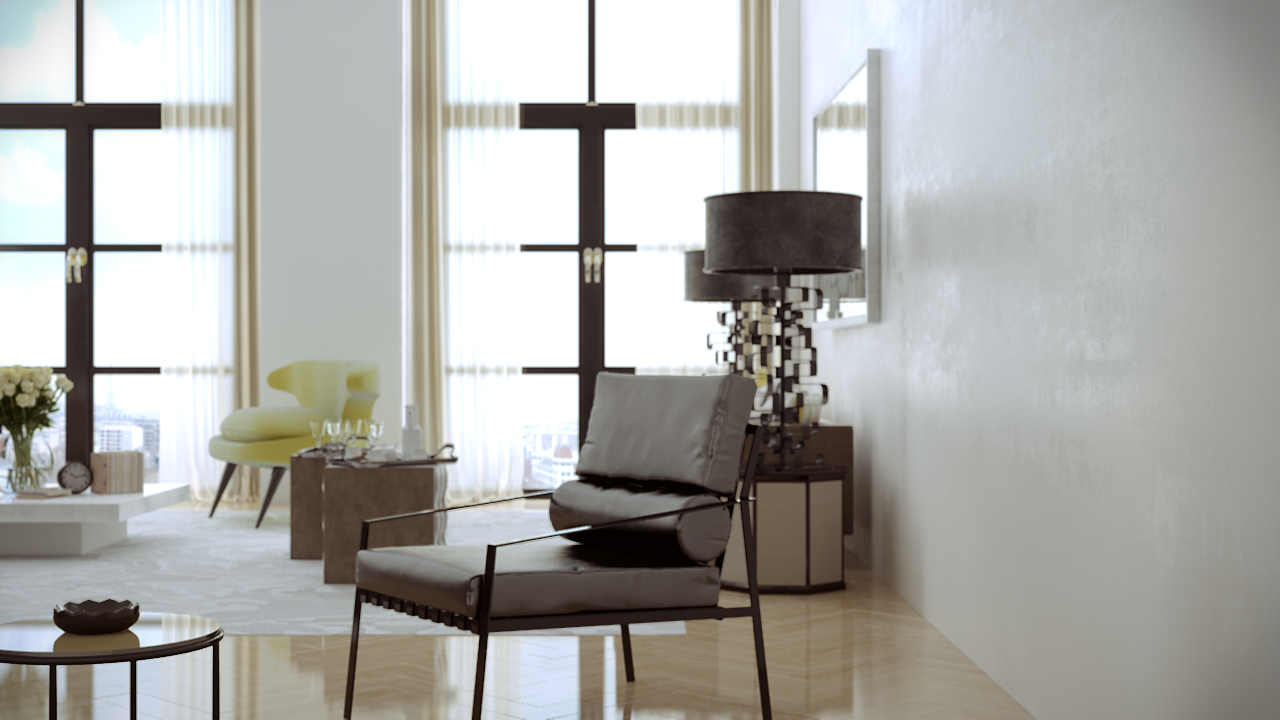

Re: room new light test
Thanks. Here one frame from animation (still render it, so later I will post whole effect with details):
