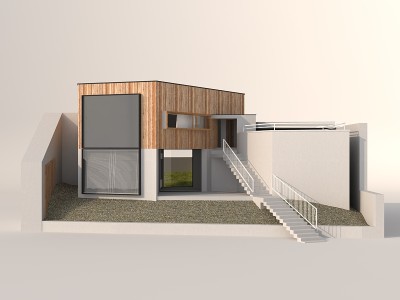

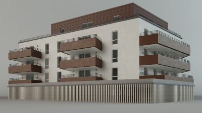

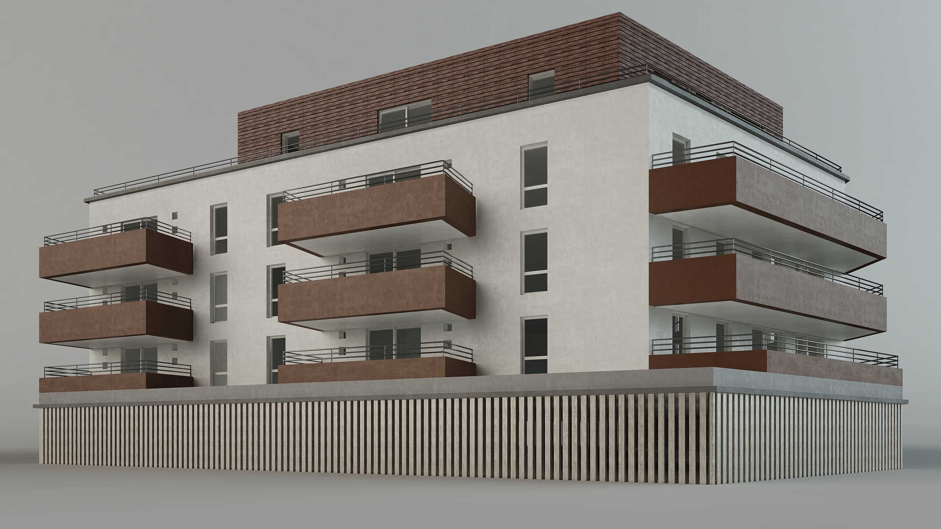

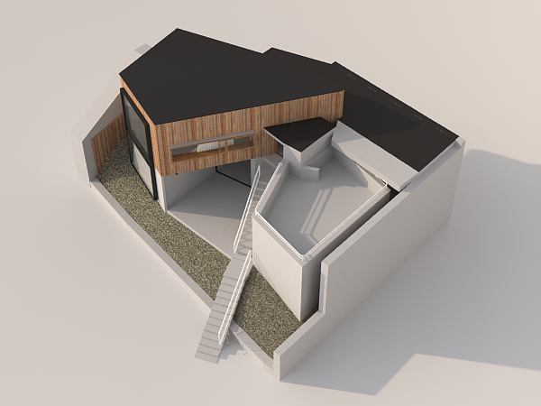

Hi!
What is the best way to render studio setup to exterior setup?
Studio setup
Studio setup
Exterior setup
Exterior setup

Thank for this question. Actually I needed something that for fast preview :wink:
Remember rescale object. Do not tweak Kray settings.

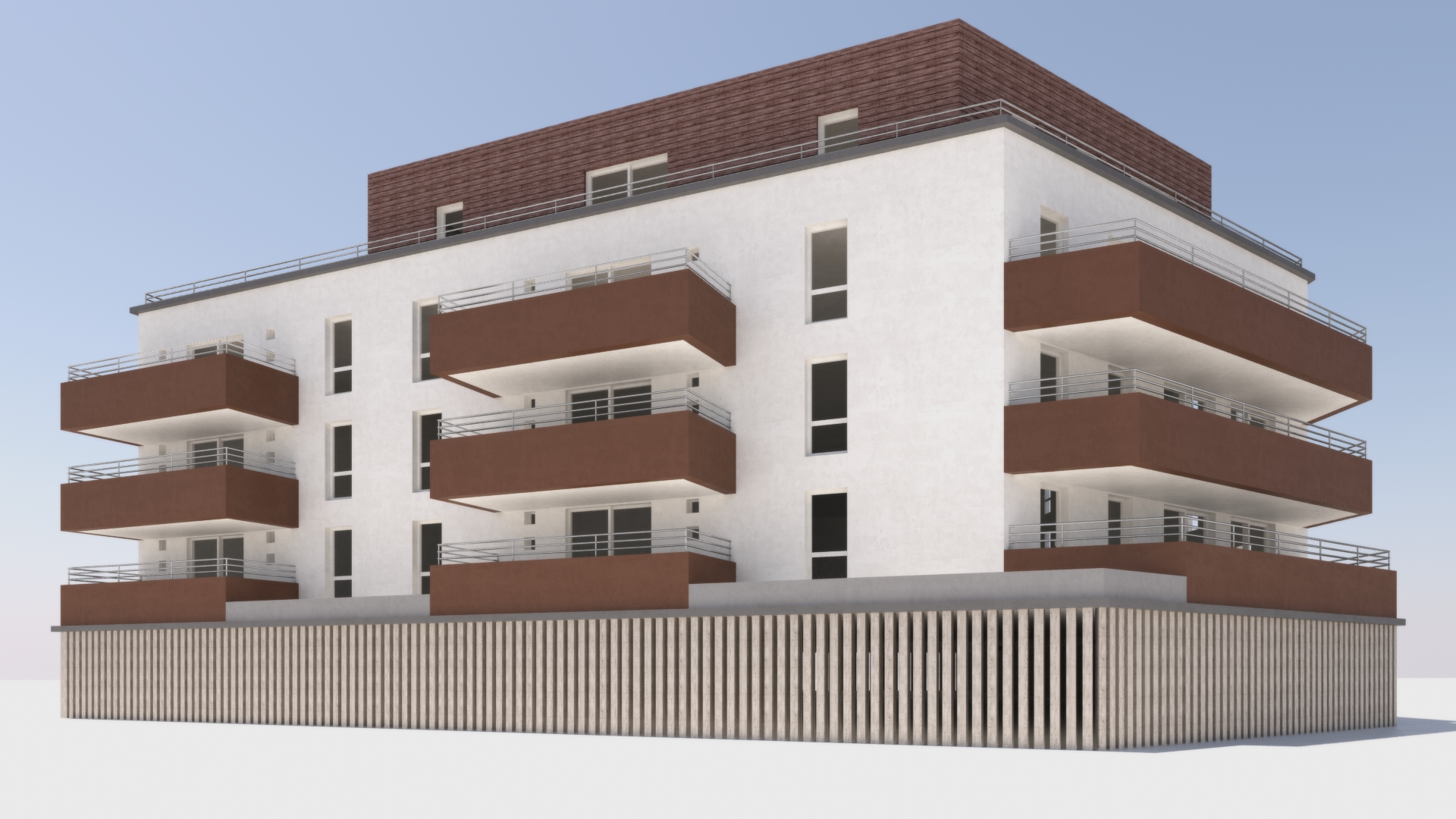

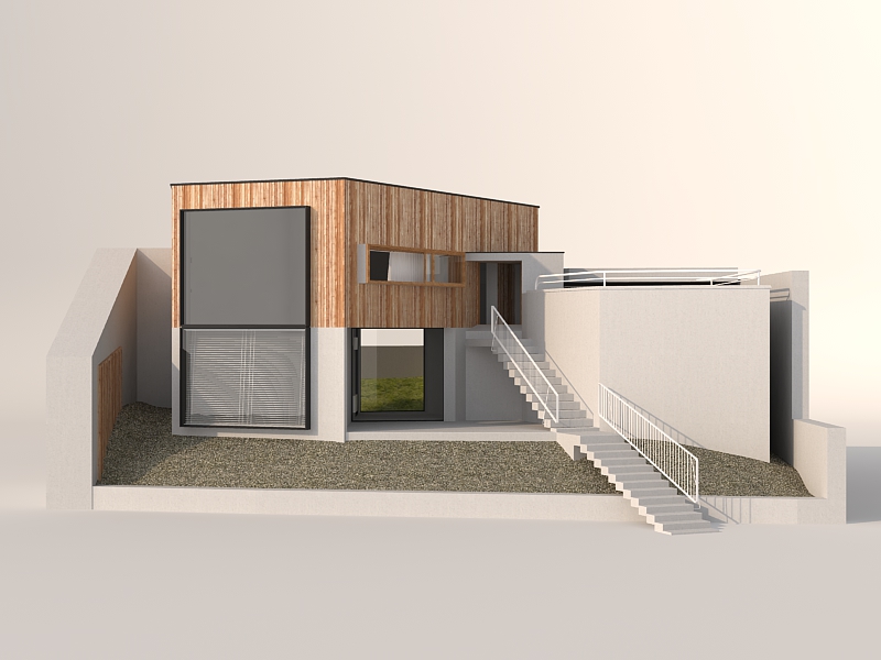

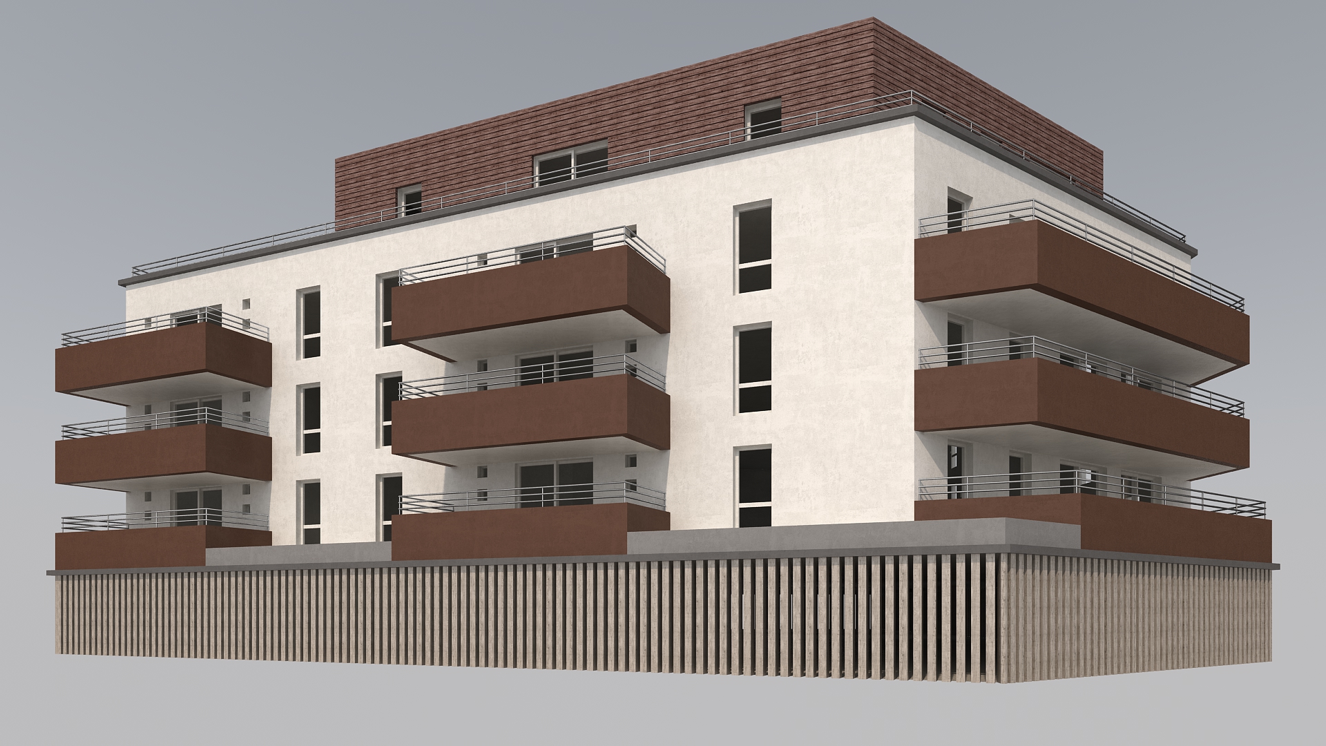

Thanks Janusz! I will try and post results.
Alek6
Posts: 60
Joined: Thu Oct 07, 2010 5:33 pm
Re: Studio to Exterior
Post by Alek6 »
Thank again, best result in textures.

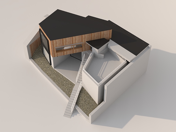

When I make a rotation of the camera, the render is the same, the modification does not make it.
What setting allows to rave this please?
I think your Auto Key in Layout is disabled.
Alek6
Posts: 60
Post by Alek6 »
No, AutoKey is enabled
Check Read-only attributes for lws file.
Check what type of camera you use...maybe something not supported by Kray?
Add new camera and then try again.
Check what camera type you selected in Kray.
Alek6
Posts: 60
Post by Alek6 »
It's a ShiftCamera, when i change it to PerspectiveCamera it works.
Why it cannot work with ShiftCamera?
