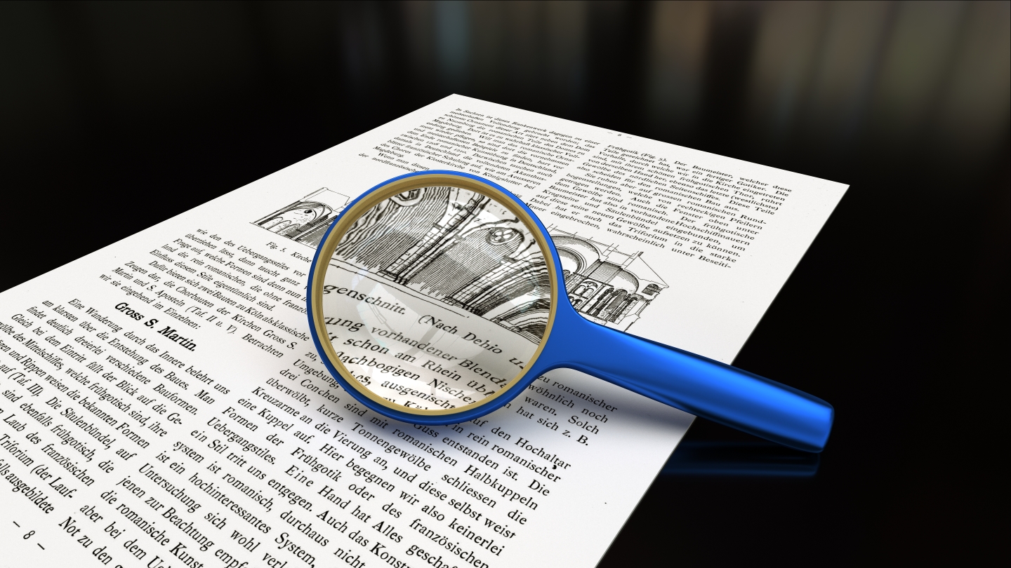

Did anyone know how to create a magnifying glass material in LW?
Thanks.

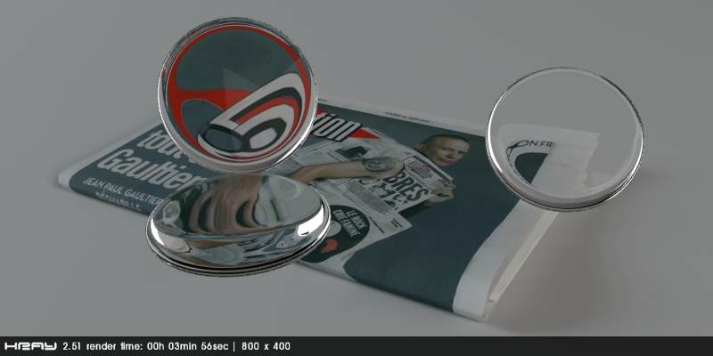

Here is the sample of glass effect..how can i do that?
Azmen S. O.
http://www.asbostudios.com
Re: magnifying glass material
I do not see any problem with that.
Just glass as lens (according to physic)
If You have problem with this I can make basic scene.
I doubt You need whole spectrum of effects for this what You want (caustic, colour spectrum refraction). So,then use just basic model of lens, according to physic. Refraction index for glass is around 1.5 but this doesn`t means you need keep it exactly. I remind, the lens effect is depends also from convexity of glass. This can be easy control by Y direction in Layout. The effect You can see immediately under LW VPR.
- lens.rar
- (7.96 KiB) Downloaded 428 times

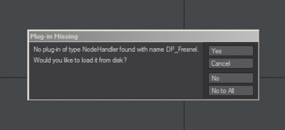

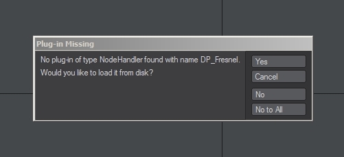

anyway i can't find where to download the DP Fresnel.
Azmen S. O.
Keep updates from here:azman_821009 wrote:anyway i can't find where to download the DP Fresnel.
http://dpont.pagesperso-orange.fr/plugi ... des_2.html
I use complex Fresnel Node.
