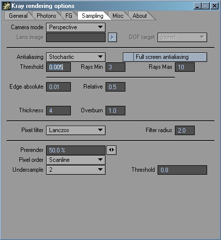

Hello, having great trouble in finding a very fast AA setting for a 720x576 pal animation. Does any one have any advice, settings, explanations of the AA side of Kray as some of my render times are approaching 2.5hours and it seems that the AA pass is taking forever, so any advice on optimising the settings would be great
Thanks in advance

The AA in 1.612 is not the fastest. Have you done some experiments with fullscreen grid3 ? That used to be the fastest as long as there is much patterns like stonefloors/walls. If the surfaces are pretty clean i would try adaptive grid1-3. The best is to wait for 1.7 wich is to pick a low number,atleast 30 times faster.

Thanks for the reply, I`m a fully paid up member so using a full version of Kray. There are a lot of texture maps in the room I'm working on, floorboards, wooden beams etc, so I dont know if the fullscreen AA would be faster. I have attached a screen grab of my AA settings (dont laugh) let me know what you think
