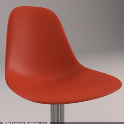

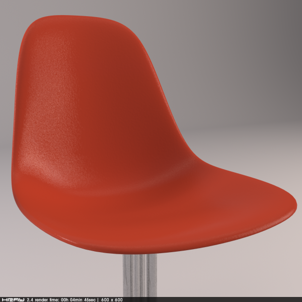

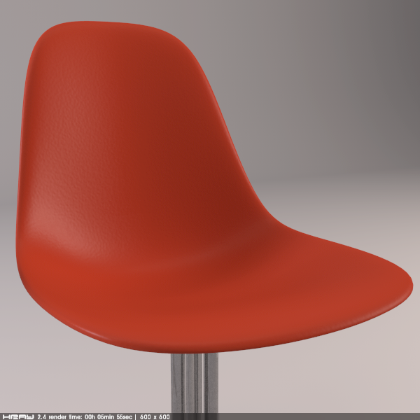

I have encountered on a small problem. I was doing some studio interior tests. For lights I used lightwave's area lights for better shadow contact because lumi polygons just dont give nice contact shadows. I had to use Trace Direct Light Reflections option because if not there are no specular highlights. But there i ran into this problem. Reflection blurring with standard Kray's QLWF produced just too much noise even when settings were very high. Than just for ''fun'' I have disabled Kray's QLWF plugin and activated Lightwave's sRGB colorspace. There were some minor color differences between renders but the reflection blurring was perfect..like it should be. I also experimented with Dpont's lights, which produced just too much highlights.
I am attaching two renders so you can see for yourself.
The method with sRGB is more time consumig (which I dont understand why) and another thing... kray's QLWF makes renders much more saturated, does anyone know why?

Remember Area Lights are raytracing physical lights so there is no interpolation..why they render slow with ideal shadows. Lumi poly has same behavior but to see good shadows You need very strong setup or UNCACHE render (which means no interpolation). Generally are no big difference between Area and Lumi if You will use no interpolation render, called UNCACHE.
I suggest not to use specular because is complicate, hard to control and make artificial effects (personally I do not use specular).
Better NOT to use TRACE DIRECT LIGHT REFLECTION from Kray...make noise in reflection.
...so the best solution (and only one imho) are Lumi Panels turned to raytracing without shadows under LW setup object. Light You will create from Area lights.
Perhaps noise was from TRACE DIRECT LIGHT REFLECTION. With Lumi blur is very fast and without noise.But there i ran into this problem. Reflection blurring with standard Kray's QLWF produced just too much noise even when settings were very high. Than just for ''fun'' I have disabled Kray's QLWF plugin and activated Lightwave's sRGB colorspace. There were some minor color differences between renders but the reflection blurring was perfect..like it should be. I also experimented with Dpont's lights, which produced just too much highlights.
About LW Gamma...You have no choice
different tone mappings make different time of render (but is not big deal) some tone mappings need a bit more calculations (there is also implicated AA phase - WHY when we setup pure Exponential and Catmull pixel filter - render is not that sharp as should be because Exponential is very strong tone mapping). About LWF make too much saturated renders: there is problem with textures, perhaps they are too saturated originally or scene has bad light. I use almost pure LWF and everything is ok (Of course almost all textures need a bit tweak because they are too bright, too dark, too saturated etc)The method with sRGB is more time consumig (which I dont understand why) and another thing... kray's QLWF makes renders much more saturated, does anyone know why?

I cannot replicate your findings but it must be because when you use LW tonemapping Kray is sampling blur in linear space which will identify contrast between blur samples more easily. You can try if you get the same effect with using importancegammamultiplier 0.5 command.medzo wrote:Hi, everybody!

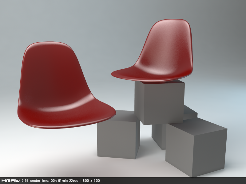

Here Your scene with setup (You can use it for interiors also)
In scene You have a couple of boxes (for testing contact shadow) and also plastic chair with high blur. Setup for blur is huge but remember high luminosity value need high setup of blur ...why I use Area lights + blur with small luminosity value.
In scene You have Area lights which are switched to Lumi poly in Kray menu.
Tone mapping : LWF Gamma with small amount of Exponential.
