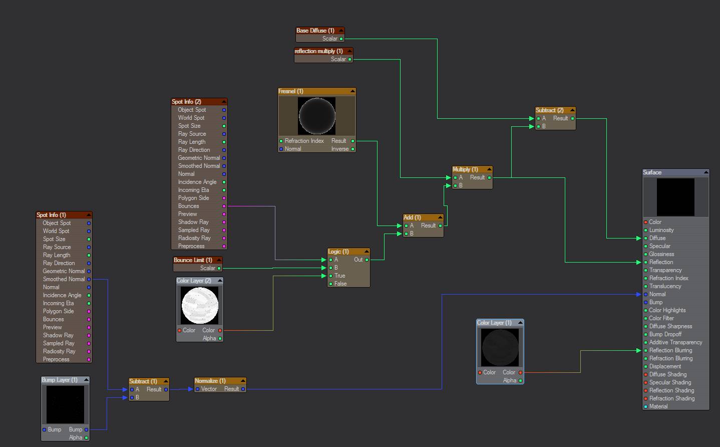

I use only NODEs (reflection connected with diffuse and fresnel + limited reflection and bump map transformed to NORMAL map) . even blurr I put as texture in Node.Imho this Is only ONE way to get good surfacing...

Very interesting node. I like the idea of limited reflection -probably this speeds up renders and how you set up bump is also something new. But I have a question: why do you combine fresnel and reflection map with ADD node and not with MULTIPLY NODE?

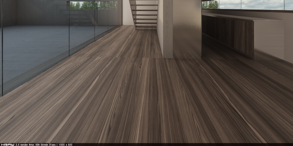

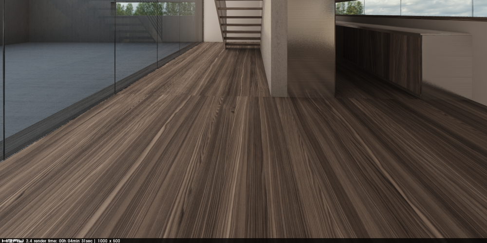

medzo
Posts: 151
Re: Clear-Coated Material
Post by medzo »
quick test
reflection multiply node
reflection add node with limited bounce

medzo wrote:Very interesting node. I like the idea of limited reflection -probably this speeds up renders and how you set up bump is also something new. But I have a question: why do you combine fresnel and reflection map with ADD node and not with MULTIPLY NODE?
Maybe You are right...maybe should be MULTIPLY NODE.
Also important is good gray scale map for reflection channel and special gray scale map for blur NODE (I control there with layer opacity , but not strong 5%-15% depends what kind of blur You want)
