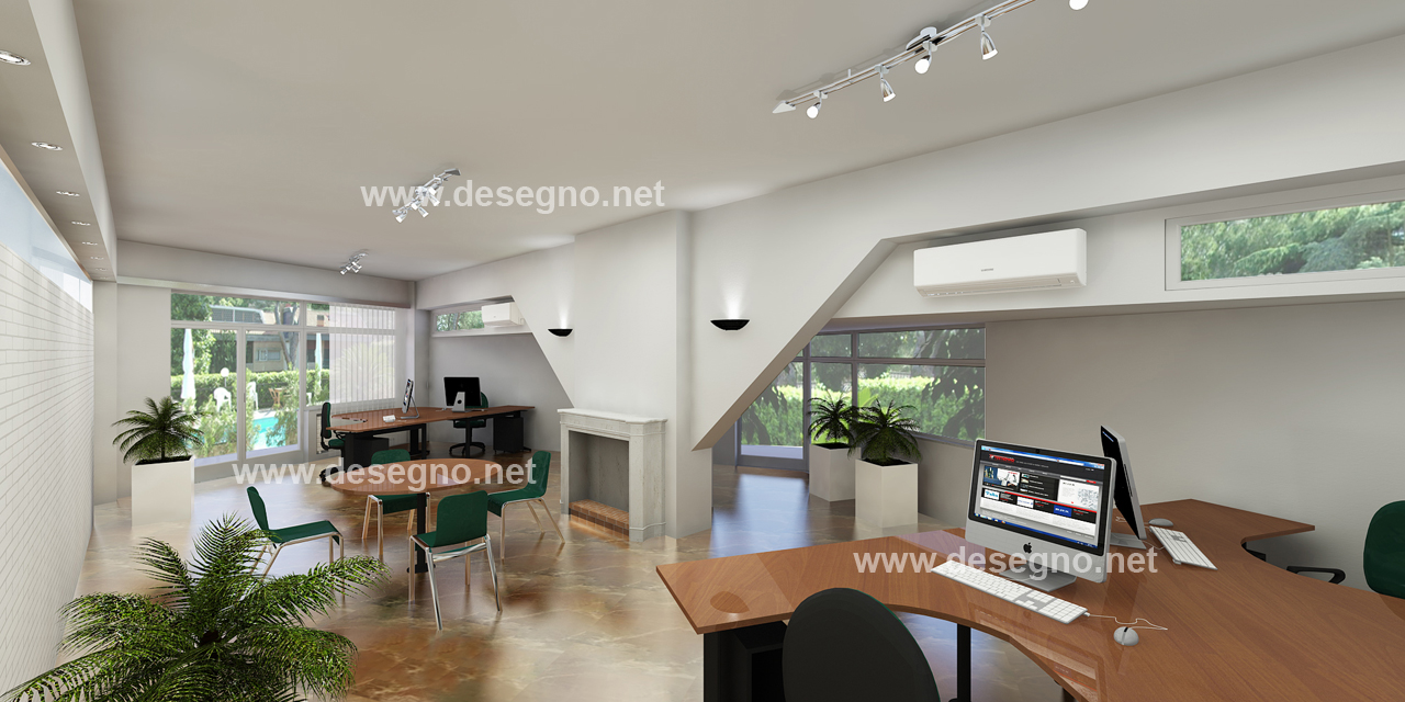

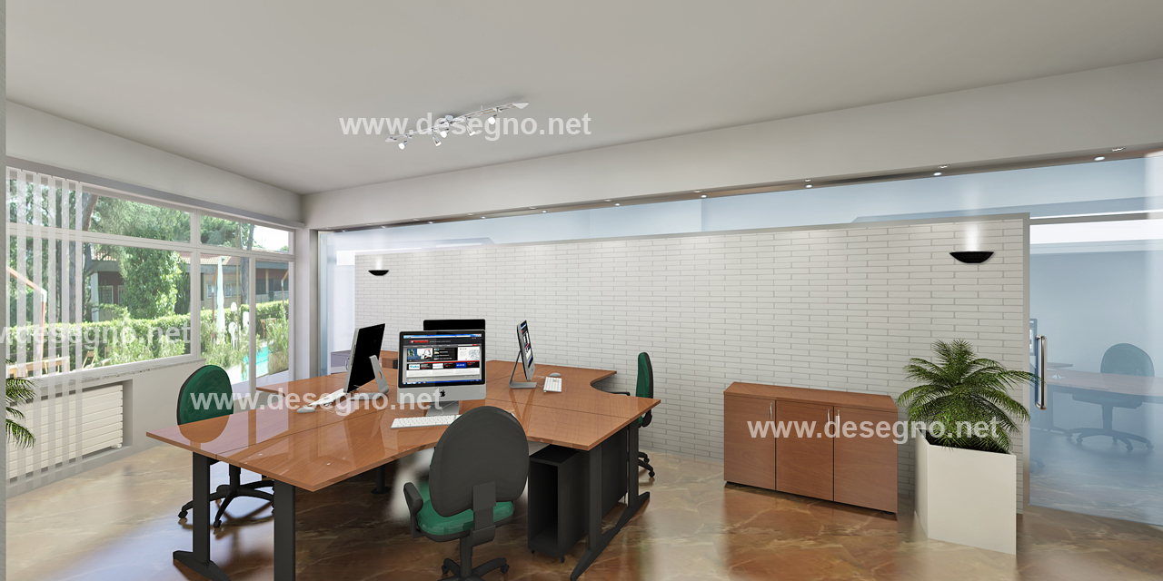

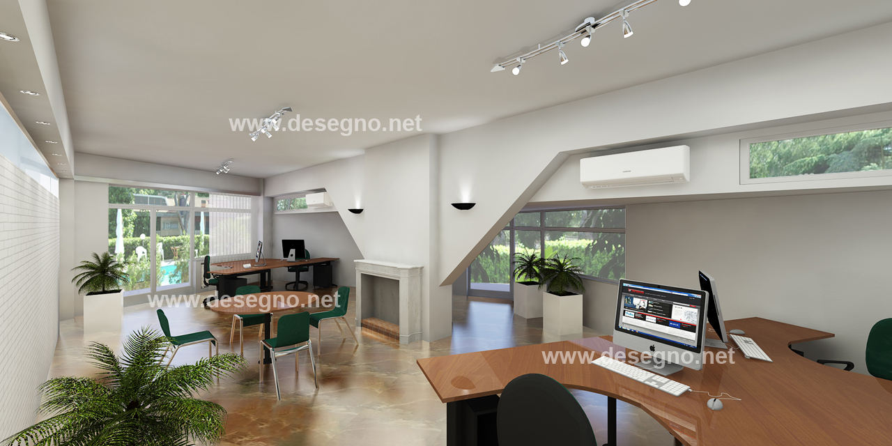

this is the last work for a client.
model in rhino, render in kray
all models are us..only office chairs are free model (low quality)
1 day for model and render
wow Nico!
very good render ! I like it!
clean render but maybe you need a little more FG because I don't see shadows near the objects
Very fast work. You keep high quality/price
Very nice work, but some constructive critique: the floor looks weird. If it is marble then it would be very smooth and hard stone with some imperfections in some places. You have a reflection that is perfect all over, doesn't fade with the fresnel angle of incidence (or not enough), and has a pretty blurry reflection.
I love the visual look of blurry reflections, but the reflections on a marble floor should be much sharper (maybe 1 or 2 percent reflection blurring). Too keep it from looking too computery and artificial make sure that the reflections 'fade out' in the end portions (so use a very sharp incidence angle gradient). Then add some imperfections, as depending on the age of the floor there will be areas that are more worn out (more matte and less reflective - you can use the same grayscale map for both of these parameters) and some tiny tiny pits where there's no reflection at all - these perfections are mostly so tiny that I wouldn't put these in though.
