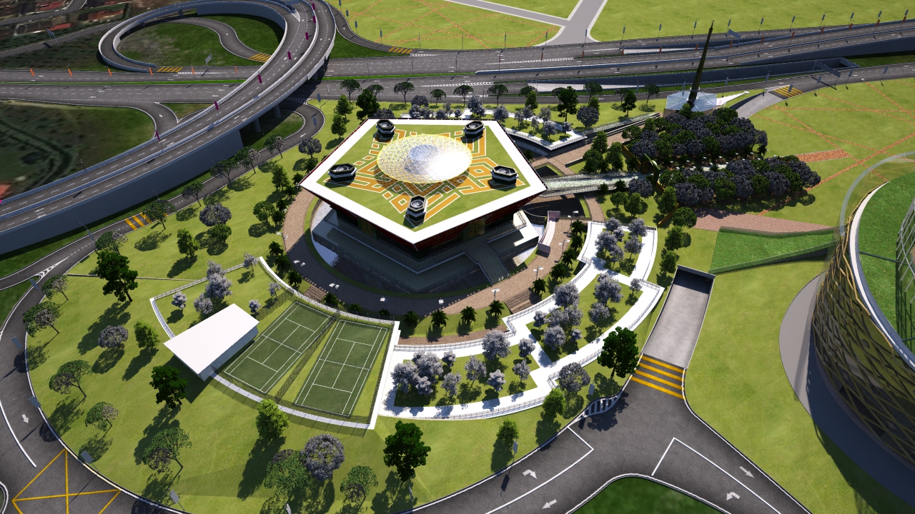

Finally found the problems. The points problem, I'm not sure what wrong with the points but I re-points again and it's work. But I have problem with the material on the surface when made the instancing.
Here I attached the image for your reference. Also this is not the final but almost 80% finish. I want to make the animation soon, so do you have any idea for the setting with this? This rendered took almost half an hour.
Thanks.
Thanks.
Re: Kray instance problem in LW10
...just uncheck USE COLOR in instance plugin (I see one kind tree with this problem).

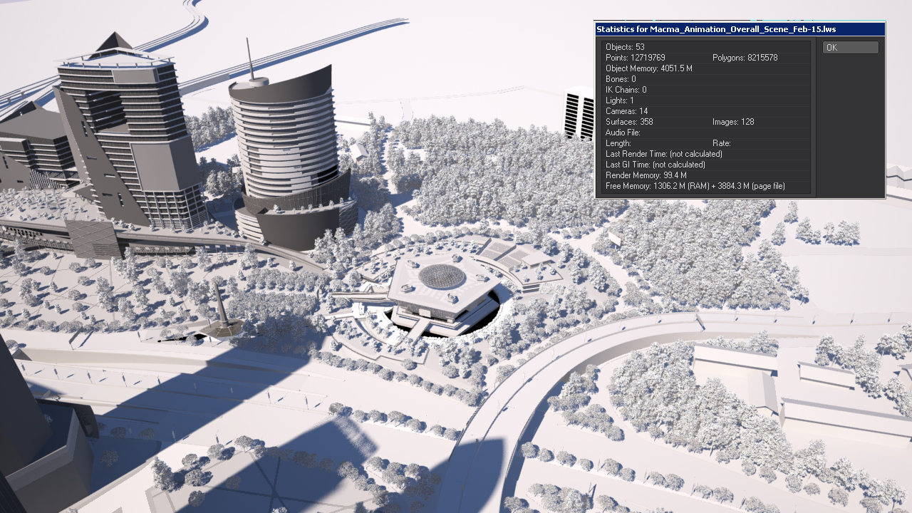

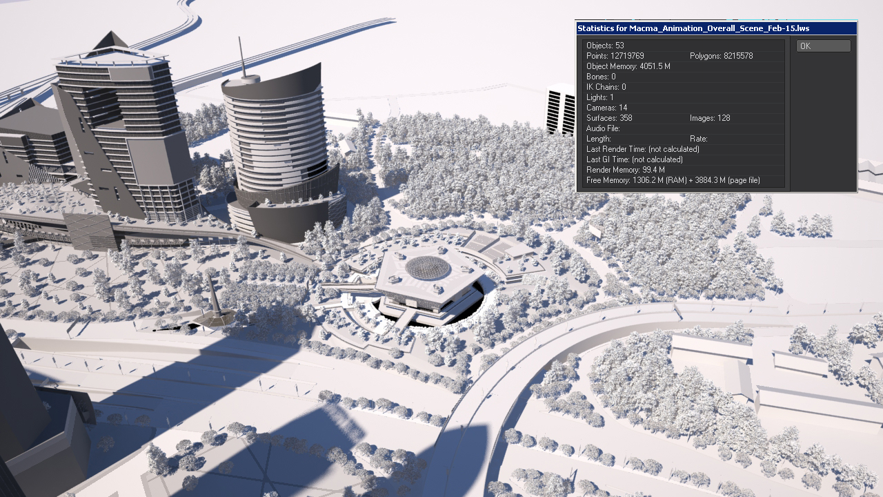

OK, this is the latest clay-render in kray. I've a problem for the render time. In clay render it just took about 5-6 minutes but when I tried to render in RGB it took more than 8 days. It ridiculous   . Any idea guys.
 . Any idea guys.
Thanks.
Azmen
						 . Any idea guys.
 . Any idea guys.Thanks.
Azmen

Can be 1000 reasons of that. Do you have Kray surface shader with QMC (Uncache 100/0) on the leafs?

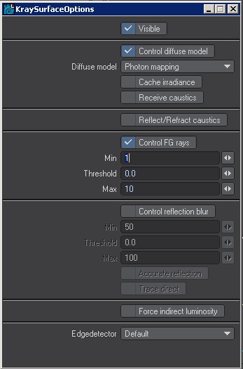

1000 reason of this? Hehe.Janusz Biela wrote:Can be 1000 reasons of that. Do you have Kray surface shader with QMC (Uncache 100/0) on the leafs?
Yes, I have a Kray surface shader (min1-max10)..
ok. So next, check setup of leafs (maybe you have transparency?...this can kill time render) or you have Node setup with something not supported by Kray...

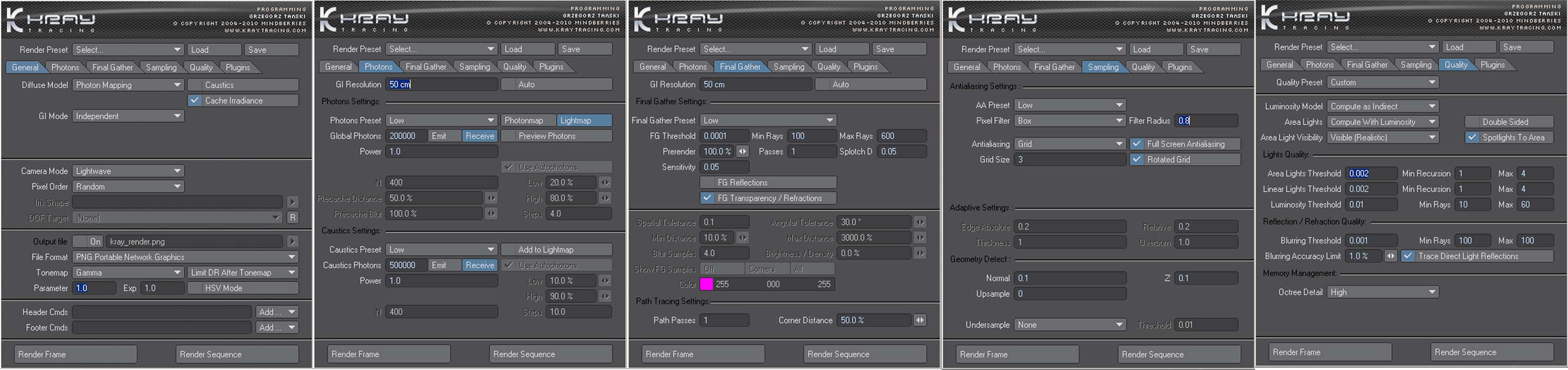

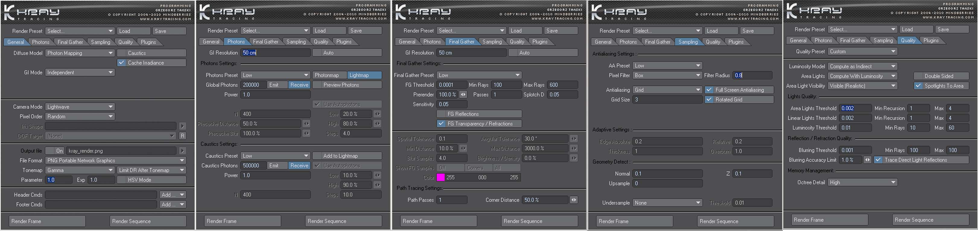

OK, i was double check and leafs are fine. No transparency. Yes, I've a node setup on the building but just only a few objects.
How about the Kray setting?
