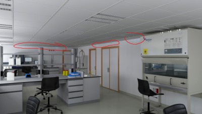

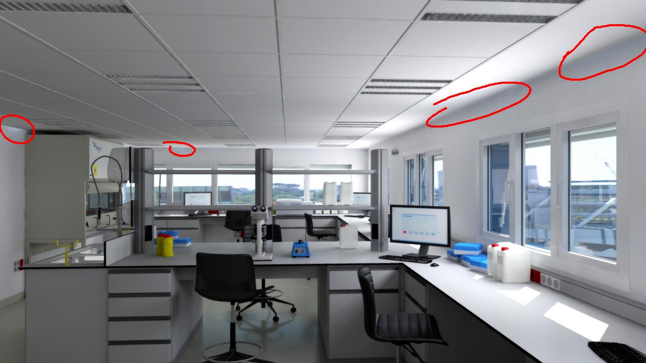

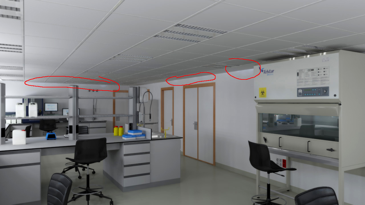

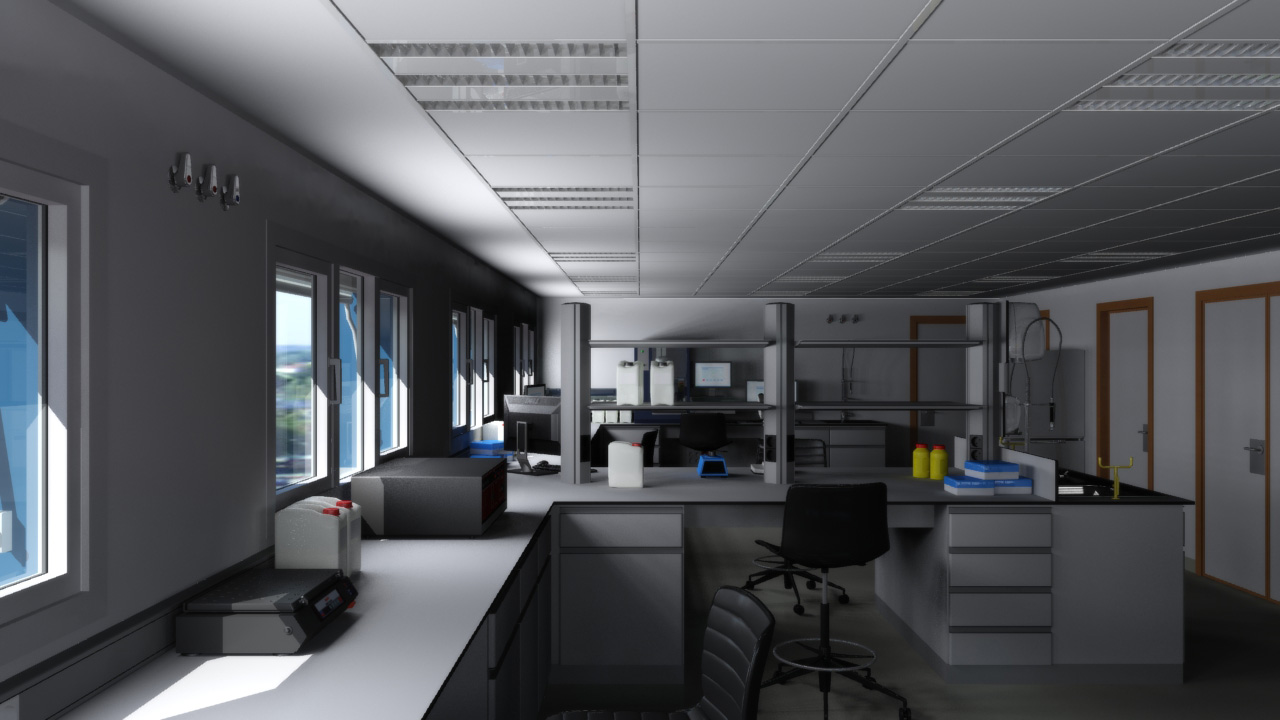

I`m doing a animation in kray an use share for all frames with 1 pass but I´ve benn unable to fix this blue splotches.
Any suggestions are wellcome. I use the Janusz config with a little modifications.

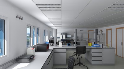

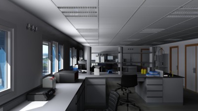

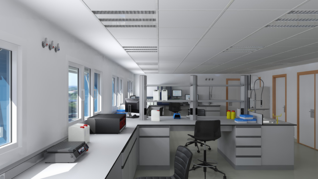

This problem is more important for me. I´ll try to explain it.
When I load a preset to set up a scene, all works ok until load another object in the scene. Then, the set up don´t work properly.
In this example I load the scene with his preset but when I try to modify any parameter the render change radically as Kray
don´t apply GI.
This problem happens to me many times and looks like a bug
Look OK
Look OK
Look BAD
Look BAD

First one looks like a leak in the photon map. So try more photons and check photon maps for any leaks.
Second looks like a bug indeed and I think it happened to me before. Is it reproducable, does it happen every time? If yes then I would be very happy if you could send me the scene to fix it...

Ok, thanks. i´ll try this.
At the second question, today i have not problem with this scene :shock: but it has happened several times but today no.
There are witches in my PC :o .
When it happens again i´ll send you the scene.
