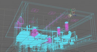

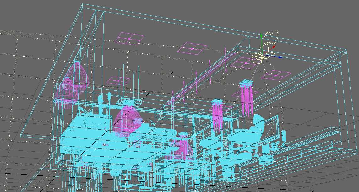

I use always small area lights (one side shot direction to floor, around 0.5 m size, every 1 m, small intensity )...just "ambient light trick". I saw in V-ray renders my fiend used sometimes 10-20 small area lights on the ceiling in whole apartment...

You have to put Area lights in places where is too dark (last time I find something interesting: I put for area Power 4-5, rest lights normal)nico wrote:@ Janusz

I test now the same but with Lumi Poly. It is much faster. I can`t cancel IES (I need it for effect) but I noticed : over kind of amount Area Kray starts render slow (it is normal: too many sources of light). With Lumi this problem does not exist
I just create one lumi panel with Power 3 and I clone it under LW (+ command lwo2unseenbyrays_affectsgi 0; to hide it)
