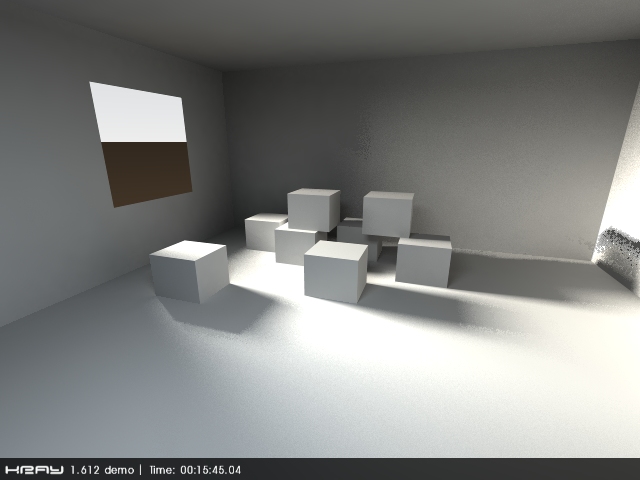

Testing lw9, kray seams to be working fine here. Any words about this?
GI file set to both, render, then change multiplier value in GI settings. This doesnt effect render. Have to set it to save... Is this a buggie or am I missunderstanding this?
Does Luminosity model set to "Auto" fail on some occasions?
Image bellow, whats wrong with my settings?
3200 cells, lightmap receive mode , 200,000 ph 3000 N
Thanks :)

try simply to use higher Arelight threesholds, i.e 2-4 or even 4-4.
You'll get clean areashadows then.
Paolo
Probably what Paolo said...

Mostly it's enough to lower treshold from 0.02 to 0.01 and it goes faster to render than forcing kray to always use let's say 3min 4max. The tolerance values is a way to tell what quality you want so if you would set tolerance to 0.0 you tell kray to tolerate 0% noise so it would always use the max value and never the min value. Happy Kray'ing :-)
