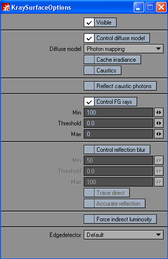

This is my the best setup (very basic) I use it on plants, grass, barks, etc.
It is good compromise between speed and quality. Noise You can reduce from PS (the best way is use ID_MAP for extract plants to layer and clean it.
G. start now update code GI for that part of renders (I mean : another detection samples for small obiects) after that we will forget QMC...

Now I have two more questions to Johny_quick:
1. What is the difference between Min 100 / Max 0 (your setup) and Min 100 / Max 100?
2. Why do both of you recommend to turn of "Cache irradiance" to speed up rendering? I thought turning it on will speed things up and it should only be turned off when getting splotchy areas in the scene?
Thanks for your help.
Re: Speed up AA on objects
1/ I think is no difference (You can test) but from my test: lower is too noise, higher is too long render ...soo compromise between speed and quality.
2/ this means: QMC render in this region...so no splotches but noise. Why I told about update Engine render from G. This regions (leafs, small obiects, grass..) needs special treating and QMC is only temporary medicine.
You can also put "Cache irradiance" ON with min/max 0/0. This is very good but still too much slow (imho not good for grass and leafs, good for barks)
