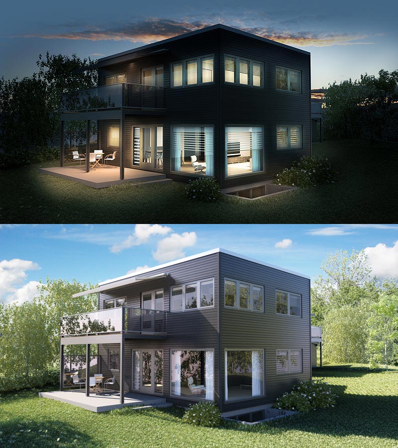

Box-house day/Night
Re: Box-house day/Night
Something doesn't quite look right here to me. The model needs visible light fittings to cast light from. The house looks like it is in pools of light and it just isn't realistic. You have a beautifully-detailed and textured model but the lighting looks weird. I don't know if you have added too much pp or not set the lights up properly.
I really liked the daytime renders you posted previously, but not these. There is something odd about these images that is difficult to describe. They look kind of unnatural.
What is the external wall material? If it is metal I think it has too much blur. If it is timber, it shouldn't have any. I have never seen any domestic cladding quite as glossy as this.
