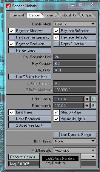

Re: butterfly net render
How to configure kray to run with bnr? I'm testing out trialversion.
I have a test scene that renders ok in bnr using lw render. If I switch to kray render I get error in bnr. Two pc only and lw on bnr is good.
renders ok with lw
I save scene with this setting. Also tried kray imagesaver ON,lw Save rgb OFF. Also tried both ON. Also tried outputtlw 1 tailer command. Still get error.
some error I dont understand if I choose kray render
renders ok with lw
Make sure that your kray plugins in BNR are the same version as the ones in LW.
To check error message details click on node and open trace logs. Check what it says there...
I did a reinstall of a fresh lightwave and bnr. And only installed kray on that with its own config files. It still works with lw only.
And I tried to render with controller and node in the same pc but there's still the same error.
12-06 [23:49:01] RenderNode:PCQUADVISTA-PC01 - Frame(0) not found! - Scene=scenek - \\Pcquadvista-pc\i\Krender\frames\
- - Check Paths
The paths are correct and renders if I choose lw renderer. But that comes out if I choose kray. Do I need to set anything in kray? Which is the best network renderer for kray?
- - Check Paths
If it works with LW it should work with Kray. Only thing you need to do is to select Kray renderer in render globabls (this is done automatically by default when you press render in Kray GUI so it shouldn't be the problem there).geo_n wrote:I did a reinstall of a fresh lightwave and bnr. And only installed kray on that with its own config files. It still works with lw only.
- - Check Paths
Most of the time problem is that BNR cannot find Kray plugin... Without seeing logs it's hard to say...
Best network controller is BNR from my experiences.
Yes i remember that checkmark for removing masterplugins. It was checked. I can't find it anymore. I think that could be it.
erwin zwart
- Posts: 152
Options/Configure/Configure Platforms, that should bring you to the "LightWave Windows Setup..." tab and then right column at the top.
I asked Paul an option to exclude kray from this switch.
This switch is mainly made to strip the LWS from masterplugins like Spreadsheet Editor which can crash LWSN in certain cases.
Uncheck it, I will add this little quirk to the wiki as well.
