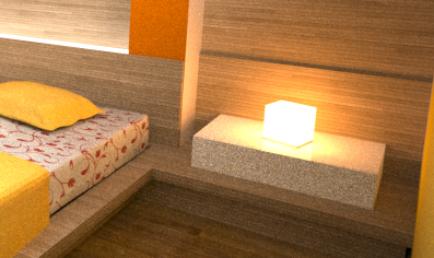

how I can obtain of the luminous polygons like this attached one?
thank's for help :oops:
there is an object to download as it? :roll:

nico wrote:how I can obtain of the luminous polygons like this attached one?

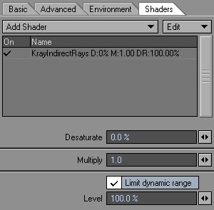

try:
500% or higher luminosity on this box (orange colour) and choice this shader on this surface.
Limitdr shader reduce very high brightnes lumi poly (this is same exponential tonemmaping but very strong)

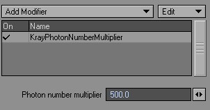

When You use SKYPORTALS You must tell Kray how strong is this light becouse You received strong light inside room from this box (then use KrayPhotonMultiply ~500) on this layer.

hi johny, thank's for rapid postreply.
i not found KrayPhotonNumberMultiply.
where is this parameter?
thank you
Re: liminous polygons
nico wrote:hi johny, thank's for rapid postreply.
thank you
Select obiect in Layout , press "m" and "Add Modifier" You will see: "KrayphotonNumberMultiplier"
