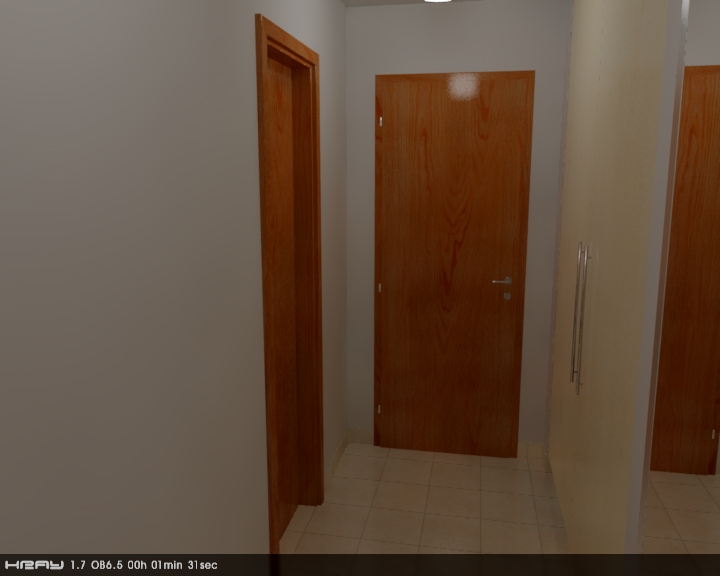

Hi all. I have problem with light stability during animation. After I convert images from hdr to tiff (Photomatix) there is different light intensity between frames and especially on the walls you can see flickering. I used time interpolation. Any ideas why? I will post some examples later today.

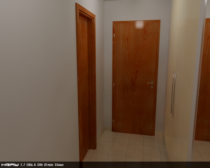

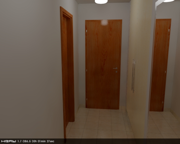

I found out that there is only 1 difference between these two frames. Anim_006 - chandelier is visible - Anim_007 no visible chandelier. GI mode (Shared for all frames, Both) during sequence render. How KRay calculate hdr then? It seems very bright object could change rendered results (brightness). For single frame render it is not a problem, but for animation it is strange issue. Anybody has the same experience?
That's very strange indeed. It looks like some kind of autoexposure is going on. Could you provide this part of your scene for testing?
