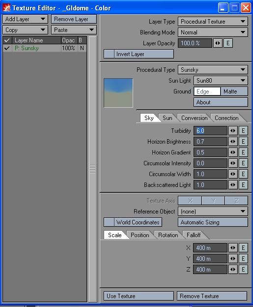

As you can see on this picture, I am getting a better light (warm and cold light on the same picture)
First: This procedural texture brought the atmosphere ( break the monochromatic look)
It's a bit tweacky because I use a a blue color for my sun (ie: 250 250 255)
and a DP texture with a turbity of 3.0.
the result is a "pure white" with a little blue gradient in the highlight (where the sun strike) and warm color in dark area. (To be close of the reality I must invert that state, because dark areas are cold and bright areas are warm)
I have to find a good balance for light and dark area.

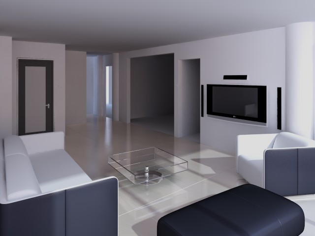

Here is an exemple of my current state (DP texture), I ma far of the previous exemple , but I am looking for this quality:

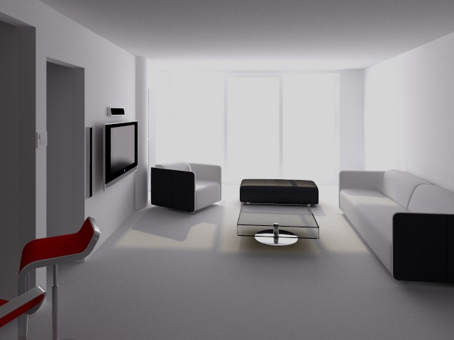

Ok I am back.
change:
The sun is yellow (you can see it : 1th rays on the floor)
Skylight texture is blue ( Horizon brightness: 0.5 ; turbidity: 6.0 ; Value: 1.65)
that is close to natural light...
During the WIP, I used caching data with low photons number to setup my shaders and find the good light balance.
For this image I turned off ""cache irradiance", and added more photons.
The result is the nice shadows (corner of the room, tv screen,etc.. )
But now I need to fix this bright light around the window. Any idea ?
Cause I am happy with the light in the room, but how can I supress or reduce this bright effect ?
please help
						change:
please help
