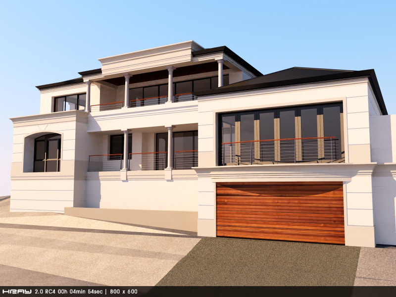

a follow up, i am also using sphere light, i noticed it render faster than area light.. from the test of 51 sec down to 40 seconds.
-light intnsity 150% , inverse dist 2, colour is linked to skylight
-skylight texture from dpont (130 brightness, and gamma 1.4 and the rest default)
-perspective camera
and kray of course
thanks again
owowow, to all. please comment on my first kray test
couple of exterior renders
Re: couple of exterior renders
I didn't know about sphere light rendering faster - interesting. I think you need to use linear workflow to get good bounce light. To do this add KrayQuickLWF to master plugins. Pick gamma 2.2, Affect all. Then in your sunsky plugin also change gamma to 2.2. In Kray main interface panel, on the general tab choose gamma 2.2 too. If this gives you too mush washed out result change it to exponential 4.4 or so...jdomingo wrote:to jure
-perspective camera
and kray of course
thanks again
I have noticed you use realy strong FG settings. I think you should use alot less rays with steps 3 (maybe 100-500). Also your spatial tolerance is realy low. I would try 0.08-0.1 for exteriors.
In the next release we will realease physky plugin and tonemap blending plugin. This will help you to get even nicer images faster. But untill then try my suggestions.

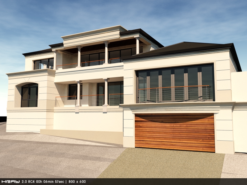

please find attached. i think it's better than my first try. settings are:
kray gen tab - exponential 3.3, exp. 1.1
LWF - gamma 2.2 affect all (i tried exponential 4.4 on this and my image turn psychedelic) so switch back to gamma 2.2
i took the rest of your suggestions and it makes me smile
thanks, looking forward for that new physky and tonemapping script
thanks again
thanks again
- Posts: 28
- Joined: Thu Mar 12, 2009 12:46 pm
I think the light setup is ok, but what you need to tweak, is the sun position. It always makes the image look a bit flat when you got the sun shining directly - or almost directly behind the camera (all the front you see is sun lit).
I'd go rotate the sun position so, that it shines from the left side of the building so, that only parts of the front is luminated by the direct sunlight...

phedian,
i did this test with rotated sun position and mmmm not what i expected. my groove lines are not showing up. any idea why? and how can i eliminate those bloches at the corner?
jure,
with the new physky plugin, will it generate a cloud like the "ozone 4" of e-onsoftware?
thanks to both
jure,
thanks to both
I think pheidian ment to turn the sun for about 45° not 90°like you did. The front should still be in sun.jdomingo wrote:phedian,
jure,
thanks to both
About the groove lines - because the facade is in shadow you need better FG solution to catch small shadows. This means you will have to up the passes on FG tab and/or decrease spatial tolerance a bit.
About clouds - there are currently no plans for adding clouds. You can use several procedural textures for clouds or even volumetrics... There are other techinques including transparent planes and such...
