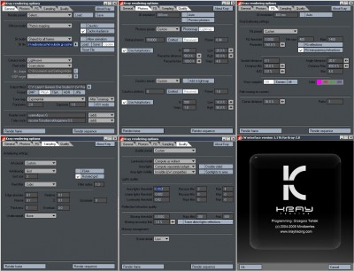

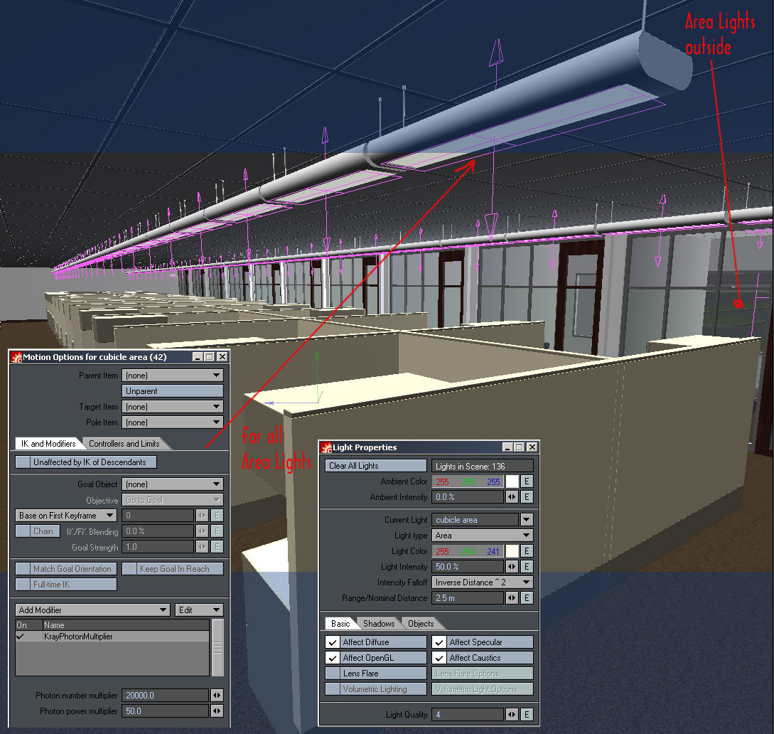

Hey everyone. I could really use some help. I've got an animation that is kicking my butt on render times. It's about a 500 frame clip, at 720x350 resolution, that is rendering out at 30 minutes a frame on an Intel Quad-Core processor with already cached GI.
I've attached a render with my settings, and a screen shot of my basic set up. If anyone can help me with some decent settings for an animation I'd greatly appreciate it. You can see that this is not getting a whole lot of natural lighting from the outside.

Instead of "million" area lights use only a few long ones. This will certainly reduce render time.
Also your photon power on the Photon tab is realy low (0.04). I don't think this is good. Use 0.3-0.5 instead. Then you will also be able to lower the area lights multiplier...

Did you reduce the number of lights? Did you perhaps try without area lights and just use lumi polys instead?

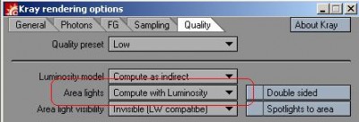

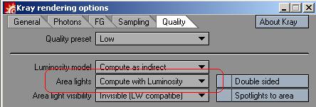

In Quality tab try to change Recurse Min/Max to 1/4, 1/3 or maybe even to 1/2 and see what will happen, as well you might try lower Area light threshold treshold
