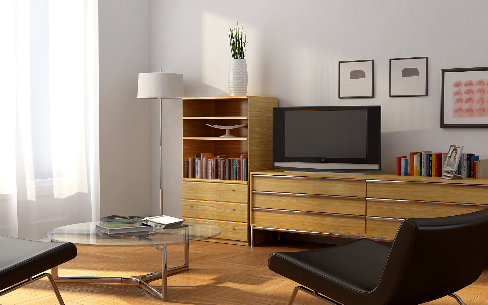

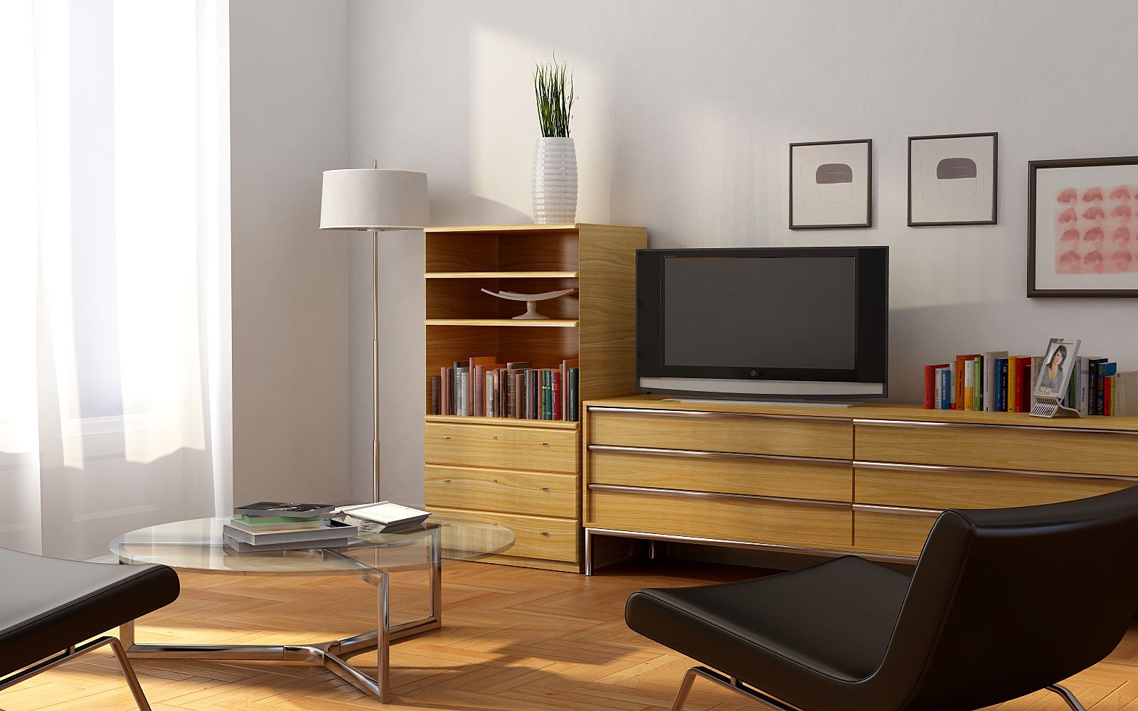

Post by salvatore »
another step forward ..
I followed the advice of Johny and I have given more power and color
I study, I try, I suffer :wink:
2 area light for the light, 1 Celine, a sun.<br />A bit of contrast in Photoshop
Re: interior
Yes this is good way!
Watch around Yourself: Tv screen is darker, ceramic have fresnel, plastic Tv have better reflection with small blurr, floor need better quality: wood texture with incidental angle alpha+greyscale texture wood (becouse floor not ideal relfect enviroment and never have ideal reflection), glass table need deep green colour and strong reflection on 90 angle, forget specular too, glass on pictures need stronger reflection.
please render big scale with FSAA G3 BOX 0.8 and after that rescale under PS to 50% of size with Bicubic Sharper.
Re: interior
good!
And fix the material of the curtain... maybe a little fabric texture.

Re: interior
Post by Leftover »
Looks good to me, but in addition to comments, i would add refraction to table's glass and looks like there are smoothing problems on metalic surfaces like drawer handles and table frame. Reflections look weird. Try to reduce smoothing angle, if it won't help you can try to break geometry apart. Like cut/paste ends of handle bars.
Posts: 406
Re: interior
Post by salvatore »
it is true. I noticed too, in making up, that the smoothing is too high in metals.
For the floor, I have only one texture arroway low resolution .. I do not think you can improve.
thanks for your comments
