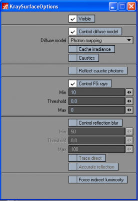

Excellent. How long is the render time? Your image is a bit small. When I rendered something with kray instanced grass it was very slow in AA pass and it took hours to render even on qc6600. Does kray have something to exclude or better control of render pass per object like 9.5 behind object exclude? Haven't tried that hidden kray hdinstance trick yet though.
Re: Exterior
Yes there is a shader that you can apply to grass surface. In the shader you control the amount of rays - we usualy use uncached FG min1 max 10... it's enough for vegetation.

Thanks jure,jure wrote:Yes there is a shader that you can apply to grass surface. In the shader you control the amount of rays - we usualy use uncached FG min1 max 10... it's enough for vegetation.
I used the kray shader before and did that so fg calculation was fast. It was in the AA that it slowed down to a halt. Without the instanced grass it rendered in minutes,

tnx. will try it again. I went as low as 50 only. I'll try 10. Can you post the bigger res?
