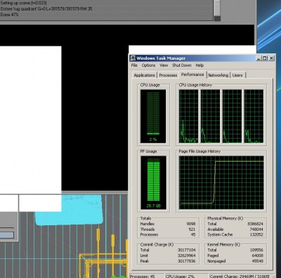

Another thing.
I am rendering an animation, I computer the GI file with the octree value in the HIGH setting, now I am loading the GI and rendering the frames with it in the NORMAL setting, but the RAM DISK cache is still rocketing to the roof, (28GB now)
is this normal?
Thanks -

Re: resampling very slow help??
Hey maybe Your scene is big and maybe You need LOW or VERY LOW octree._mats_ wrote:Another thing.
is this normal?
Thanks -
Matt -
Ofcoarse You can use NORMAL or higher but You swap memmory will be bigger.
LOW Octree is very good for all scenes.
The only reason to ever fiddle with the octree settings is if Kray literally stops rendering.
This could manifest before, (Octree calculations is much more optimized now) such as when you had for example a building and within that building you added a quite complex object with high polygon count, the room itself renders fast but every time kray should render some part or pixels of that detailed object it takes forever,almost stops.
THATS when you need to raise the octree.
An octree of 25-30 is rather high. The presets are now as this: Very low=25,Low=30,normal=35 and High settings=40.
Raising the octree manually to something above 40 would be astronomical and is not recommended for any project.
If anyone have a scene that seems to behave strange, eats up lot's of memory or still renders dog slow please send it to us so we can investigate it.
