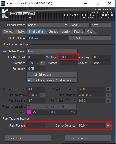

Re: Lost in Demo-Version 2.61 - HELP

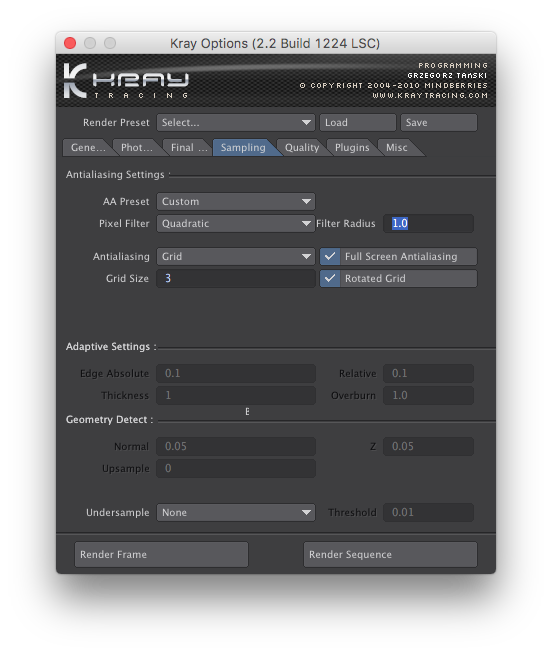

I uploaded settings for Brute Force sampling (QMC).
In this system works only amount of rays (rest options are disabled and they work only with Final Gathering)
- 100 Rays - poor quality with fast render
- 1000 Rays - good quality - slow render
- over 1000 Rays - very good quality - very slow render
Path Passes and Corner Distance you keep always the same for all render systems.
All options in Kray 3 will be disabled. There will be only 3 presets (buttons): fast/medium/high quality

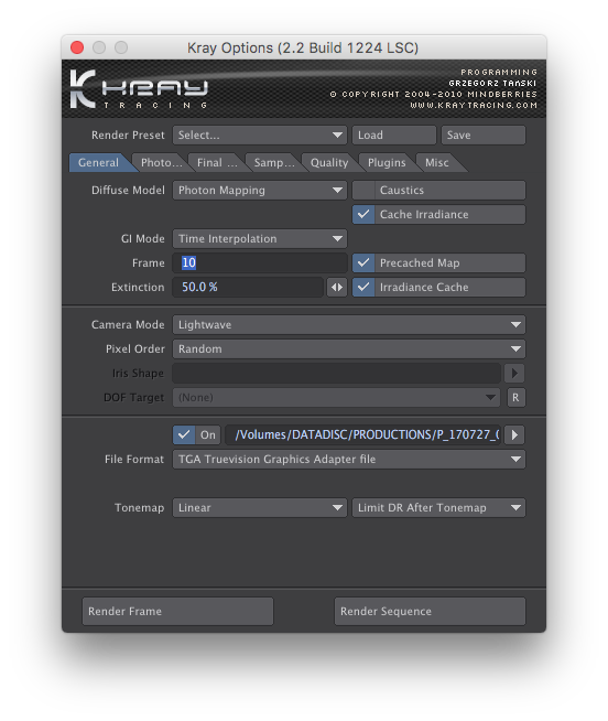

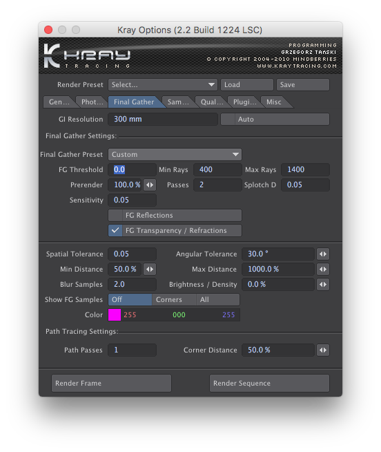

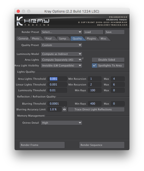

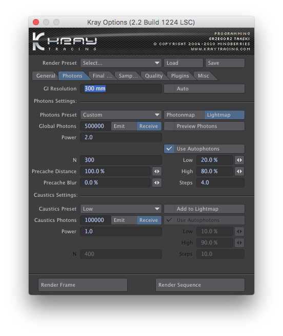

This is strange....every time Kray reaches frame 10 it crashes... does it have to do anything with the Time Interpolation,
10 frames, Precached Map and Irridiance Cache...? Are they kinds interefering?
Although, in your uploaded scene a few days ago, you showed me the Time Interpolatioon Setting and you used the same settings.
This is strange... I can't figure out what it could be...
When it renders, it's saving the TGA as defined, but also .fgi-files which might add up to a considerable amount the end.
Are this the Precached Maps or what? Can they be deleted after rendering or would they serve another purpose....?
I checked and changed that issue with Gamma, Linaer and Extrapolated.....makes sense now
I have also uploaded my actual settings.... they are based mainly on your settings from the Time Interpolated Scene a couple of days ago.
Or is it a Lightwave Bug?
Cheers,
Steven R.
Cheers,
Steven R.

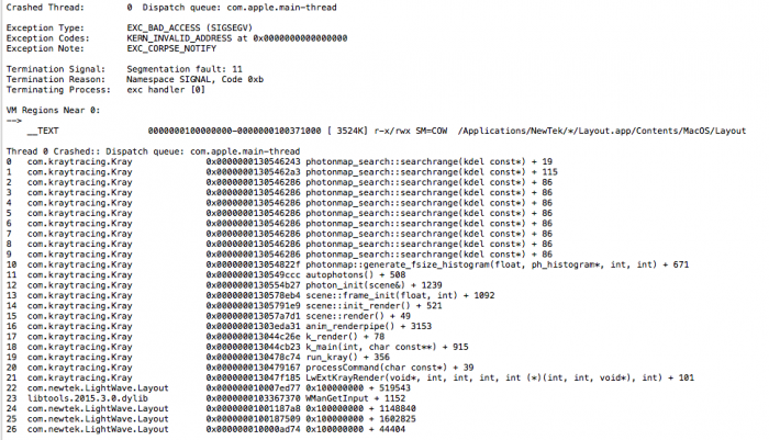

Hi there Janusz
Still experimenting around like crazy...
I downloaded CleanMyMac and did a bunch of procedures, hoping that stuff could get cleaned out,
fixing permissions, clear chaches etc etc.

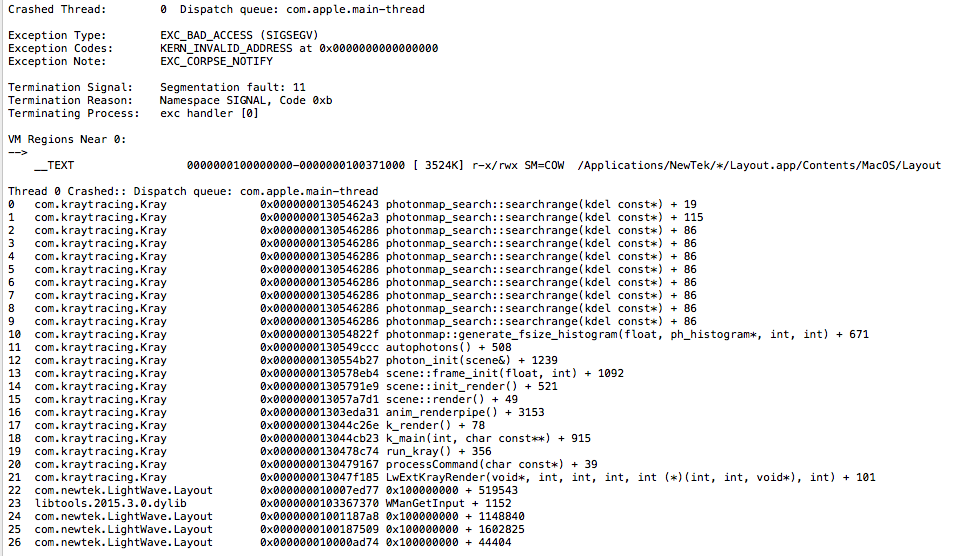

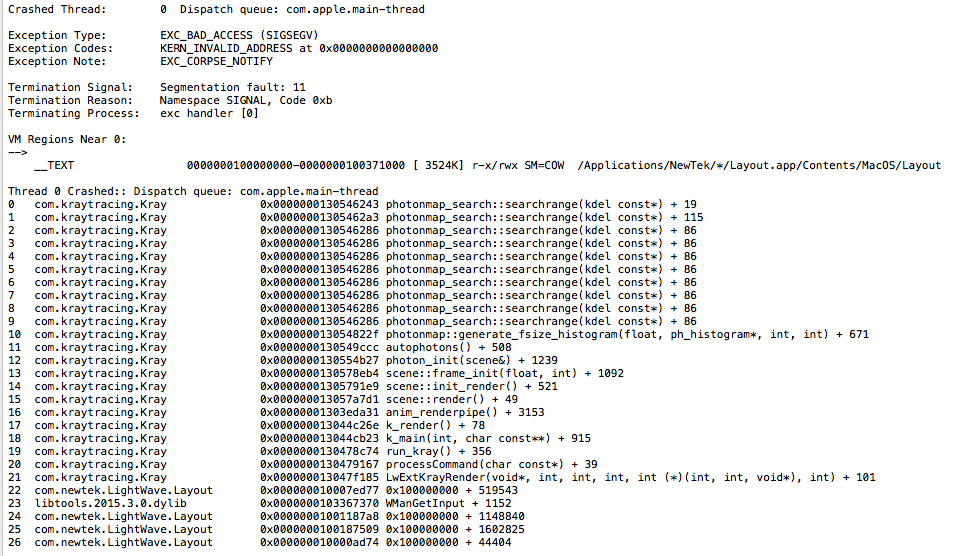

This time it rendered up till frame 13 and crashed. See attached screenshot.... the EXC_BAD_ACCESS and
KERN_INVALID stuff is giving me a bit of a head ache.... I have NO idea how to solve this without messing
up the whole system...
I know, you don't work on Macs... but are there no issues like this known to happen on Windows machines?
Any ideas?
Cheers,
StevenR.
Any ideas?
Cheers,
StevenR.
