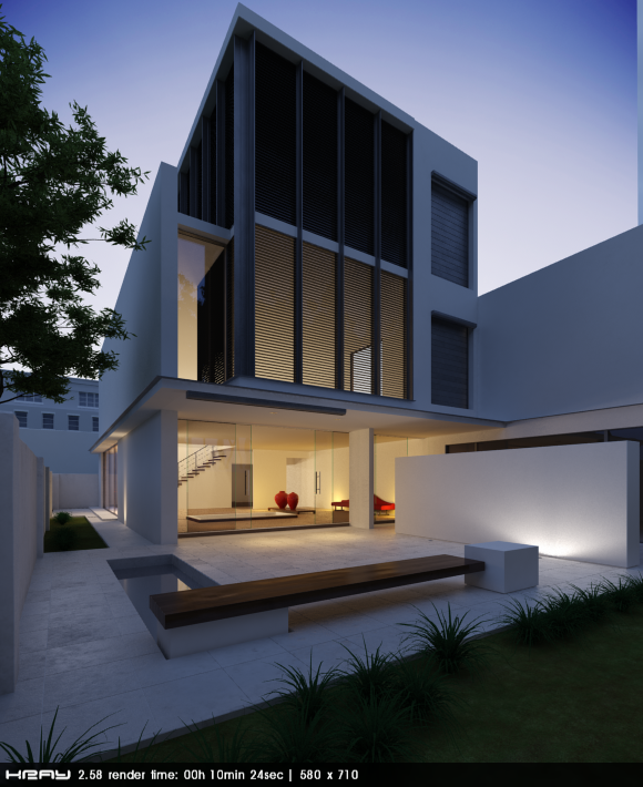

Exterior Node test
Exterior Node test
Here my fast test in QMC mode in Kray.
V-ray 6 min:
V-ray 6 min:

Actually this is just basic test of ArchExterior scene. I wanted just find way to bright up scene with LW lights and to know in which direction go with K3.graflukas wrote:Yes pretty and outstanding in this forum as always.

Scene in V-ray is render in QMC mode , same in Kray. Time is similar, maybe in Kray is has cleaner render because higher settings.
Actually is very easy setup exterior nights (I did not suspect that!) because it is similar to...Interiors settings. Problem is for full day how do bright up scene with Physky or HDRi - in this moment both are not good in Kray. Physky has old engine, HDRi is only simulated as normal HDRi map.
For HDRi will be in K3 special engine which detect source of strong lights and create for that special photons which gives Physical Light behaviour (similar to Area Light) so in render we will get stronger shadows. This new HDRi system slowly appear in other software also.
Here low settings: Here PM mode: Path Tracing: ...so we see now: QMC is quite faster then normal FG mode in some situations.
Here lights (almost the same position and system like in V-ray): Optimized version (recurse limits on windows glass: 2 recurse)+soft LWF (gamma 1.2):

V-ray render engine is really fast and has a lot shaders which make this render...more faster. Is very difficult to be close with quality in Lightwave/Kray but again I repeat: more important is work pipeline (modelling, post process, animation system, fast response)
