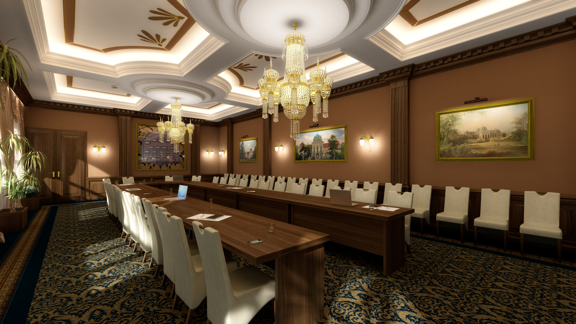

My latest project - work in progress.
I'll upload the final version later

Hello! Yes, it needs improvement in light balance. I think LEM light (luminosity panels) in windows will solve problem - just copy glass from windows and paste to empty layer and move them a couple cementers inside room. If somebody forget or do not know how create invisible LEM lights in Kray I will post short info.
There is something wrong when LEM lights and windows glasses if they are in the same place - looks as blocked photons...bug in Kray? so to avoid problems just move them 20-50 mm to inside of the room. Anyway we will not fix this because now we start K3 alpha/beta and very soon K2.x will be history. It will be also soon last K2.x update with fixed code + support for last Lightwave. I test this version since 2 weeks and it works perfect with...20-30% speed more!
You can use also Physical Sphere lights in places
where are wall lamps and ceiling lamps (I think you did that)...just do not try increase power of bulb luminescence lights too much (level 300% is maximum!...after that you will start have problems with blur quality and photons map quality).

Here's the final version.
I know that plants needs improvement, but ' had no more time to finish.
In terms of light ballance, I had to take into account the disegner's taste: highlight the interior lights
The curtains are now closed, so I could not use the copy glass trick. Insted I put area lights near the window + unchecked the csat shadow option for the curtain to let in the sunlight
Wall lamps has spherical lights, ceiling lamps has 2 spherical and 2 area (inv. dist)

Thanks for the comments!
I'd like to test this scene in K3. Will there be an open beta for K2.x customers? How to tell that I'm intrested in beta testing?

Instead using Inverse Distance 2 use 1. for lights in windows.
Try maybe one big Sphere Light (Inv.Dist.2)on the ceiling lamp instead four. Control noise for Spherical Lights and IES lights is in Kray Quality Tab - Luminosity Threshold (100/0 minimum).
LEM lights inside ceiling lamps must be for effect not for light! So keep 300% luminosity level maximum. Main light must come from Spherical Lights (1 m minimum) - this is general rule for all lamps - never try bright up rooms by strong LEM lights because this affects errors in photon maps and horrible noise blur.
Beta K3 is closed but you can write to G. request, he is always open for propositions.

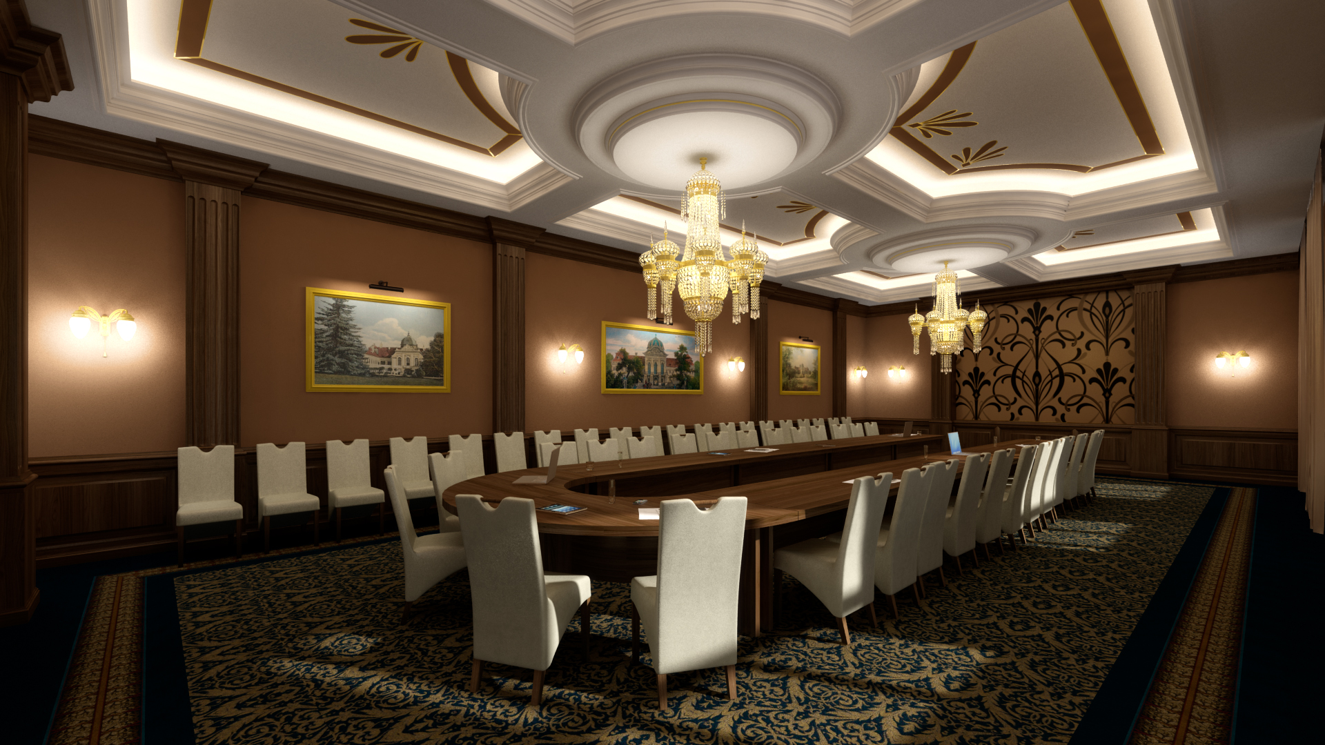

here this is my very old render old work in one day done.   idid its ithink is similaire then yours
