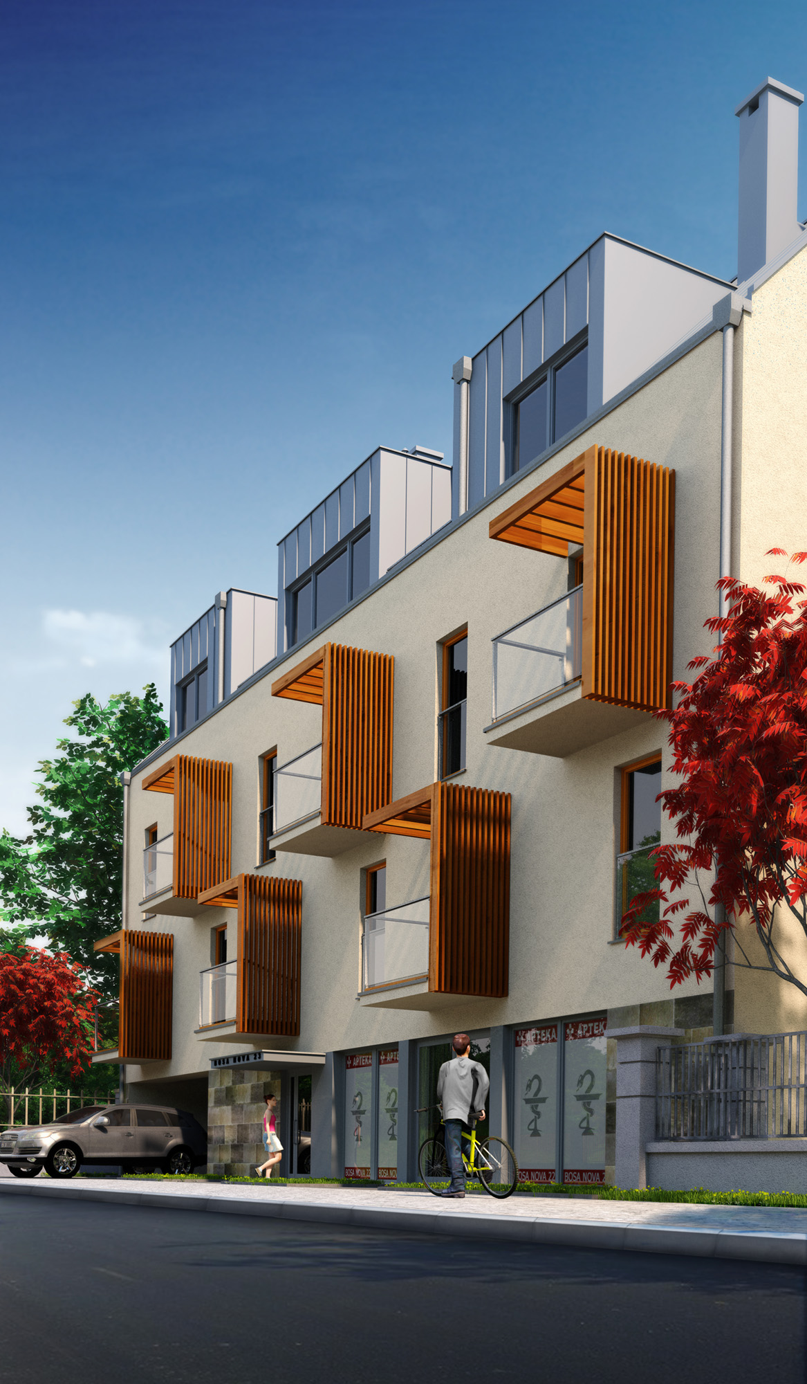

Current viz for a client.
I know it's not epic but I'm satisfied so far..
I'm not sure about composition... What do you think?
The next one /I mean project/
will be based on nodes with better textures, I hope
At this moment a lot of photoshop work.
I tried to make some good contrast and a little juicy colors for a client satisfation.
You know what I mean...
Each comment or suggestion will be welcome for next shots.
Exterior
Re: Exterior
I think this looks good. The building in my opinion has nice light. Plants bad - for that you need Nodes with translucency - soon I will start upload leafs surfaces.
Problem with plants is that - there is a lot science and physics and simulate them is terrible horror.

Re: Exterior
Yes I agree.
Leaf material is difficult and time consuming during render.
In this project all materials are based on standard surfaces, no nodes,
what is easy to see in the carpaint material. Looks ugly.
It is very confusing, to setup materials that they are looking good in studio
and watching how they looking terrible in exterior scene with a sun light.
I hope nodes will solve this problem.

Re: Exterior
There will be all materials. I need just time for it. I remind: I do not sharing materials/surfaces - I share idea/system. I show one plastic surface because from this system you can create easily infinite plastic surfaces (different colors, different reflection level- in this case controlled by Fresnel). So this is something more then just one surface. The target of Nodes amount will be ~ 20-30 and there is nothing more to show. Whole system which I use since two years back working well, fast, enough accurate, is easy to learn and logical. Amount of time which I save is incredible big - using this system I dramatically drop amount of previews renders.
Is very often when users tweak surface by changing diffuse and mixing idea of reflection/diffuse level! This is very bad idea.
In my opinion 60-80% of whole render are surfaces. It will be NEVER good render without good surfacing.
