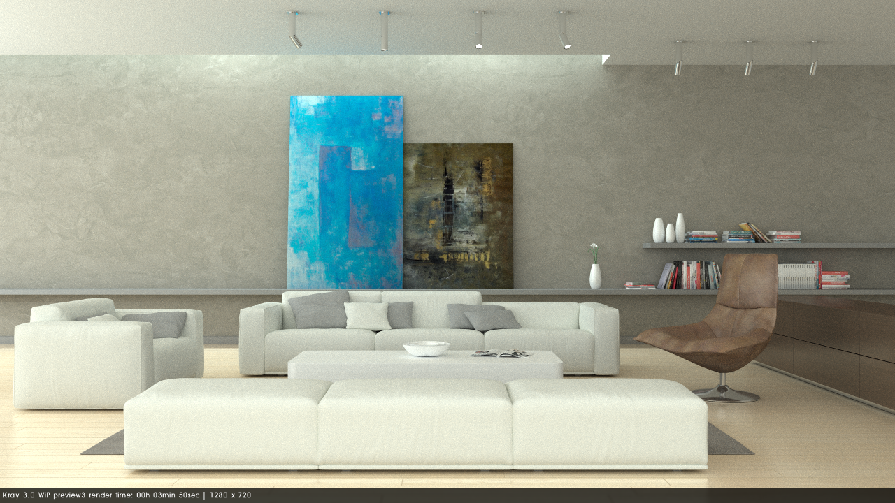

This is the progress of last pre beta version of Kray 3.0. All functions are connected except: Physky2, IES, Displacement, VPR progressive scan, Real Time Tone Map, Real Time Photon Mapping phase, new AA, new MB and some other small details.
I render it in Path Tracing because new engine of Final Gathering is not connected fully.
Time of render in bar info is not accurate (I think is bug or is not connected properly module for that - but this is detail and standard during connections)
This all was done in 2 months and person who knows what`s means coding knows how horribly fast it was done. It would be not possible without perfect documented Kray SDK and well done code of K3.
Soon new updates
Thank`s to erkerk for scene!
