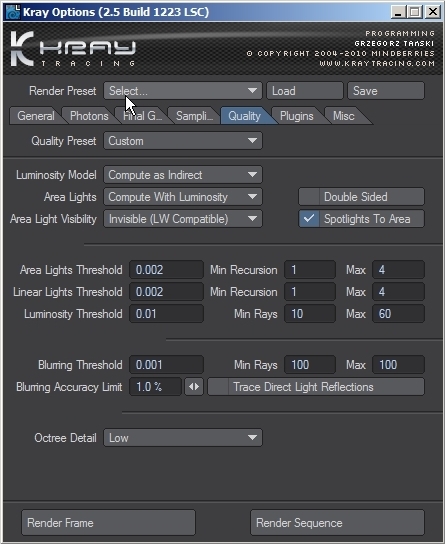

Re: night scene render
here is my setting..im still weak for night scene..
btw
Do not keep Octree low (I doubt you have small amount of RAM)
1. Reflection on walls?
2. Power of Lumi lights?

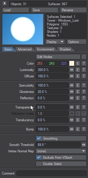

here my lumi setting..
sorry for the first question..here is the setting..
Node which is not fully supported in Kray or ...moment I remember something:
Did you used very high level of Bump Map?
				azman_821009
- Posts: 274
- Location: Kuala Lumpur
yes. i think so. not really high i think the texture amplitude is about 5-10. the rest is 100% or less..that one only for wall.Janusz Biela wrote:Node which is not fully supported in Kray or ...moment I remember something:
I think problem is from this Image World. it is LDR.
Also you have many bad setup in Kray (which doesn`t affect this error except 25 bounce light...You need maximum 12 in Kray)
Best idea is just send me part of scene (export all to another folder and delete everything what Is not needed and still keep problem)
The solution was easy to find. Contact me via Skype.
Janusz what was the problem and solution you came up with?
From first glance it looks like high specular and bump setting.
It is old bug from Kray. When you put luminosity surface + Kray Shader with switched RayTracing inside.jnom wrote:Janusz what was the problem and solution you came up with?
To avoid this problem I suggest put that surfaces in separate layer and then use LW raytracing flag.
